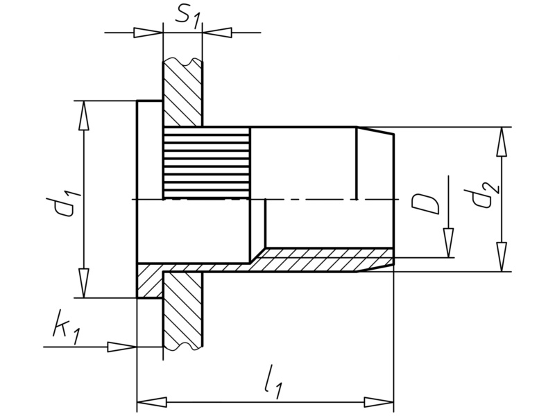

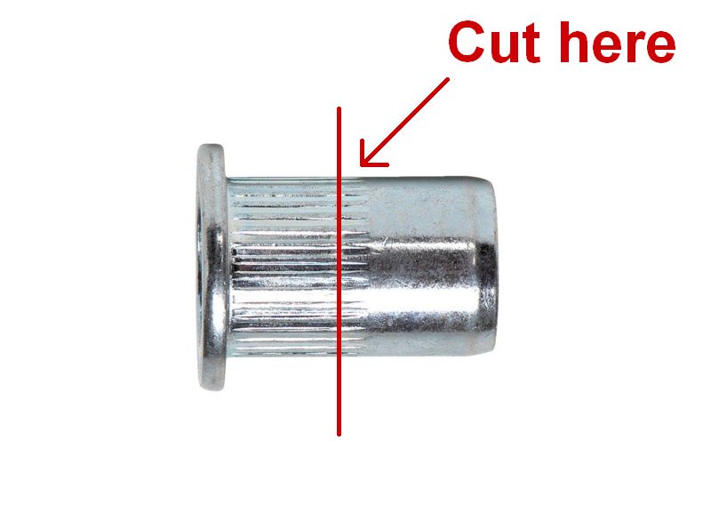

I would try a M4 rivet nut, with a shorted length and a little Loctite
eshop.wuerth.de/Rivet-nut-with-round-pan...%2004.sku/en/US/EUR/
Thread type x nominal diameter (D): M4
Head diameter (d1): 9 mm
Outer diameter (d2): 5.9 mm
Length (l1): 11 mm
Head height: (k1): 1.1 mm
Length (l1): 11 mm
