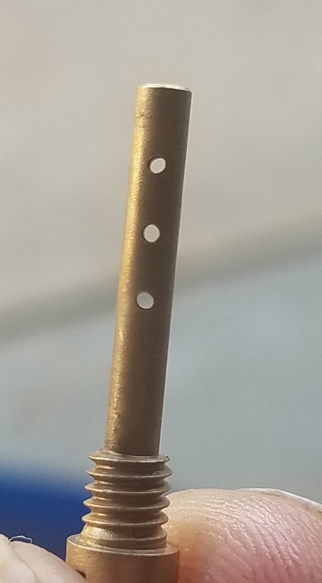

The pilot jets are very small. Use a guitar string or wire brush strand to be sure they're clear.

I checked the carbs but I could not see anything out of place or suspect. Checked the pilot jet on the dead (right) side and it seems to be clean (pic attached).
I put a piece a shop towel on each exhaust and that way I was able to smell fuel on the right side exhaust. I have spark but the mix is still passing through.
