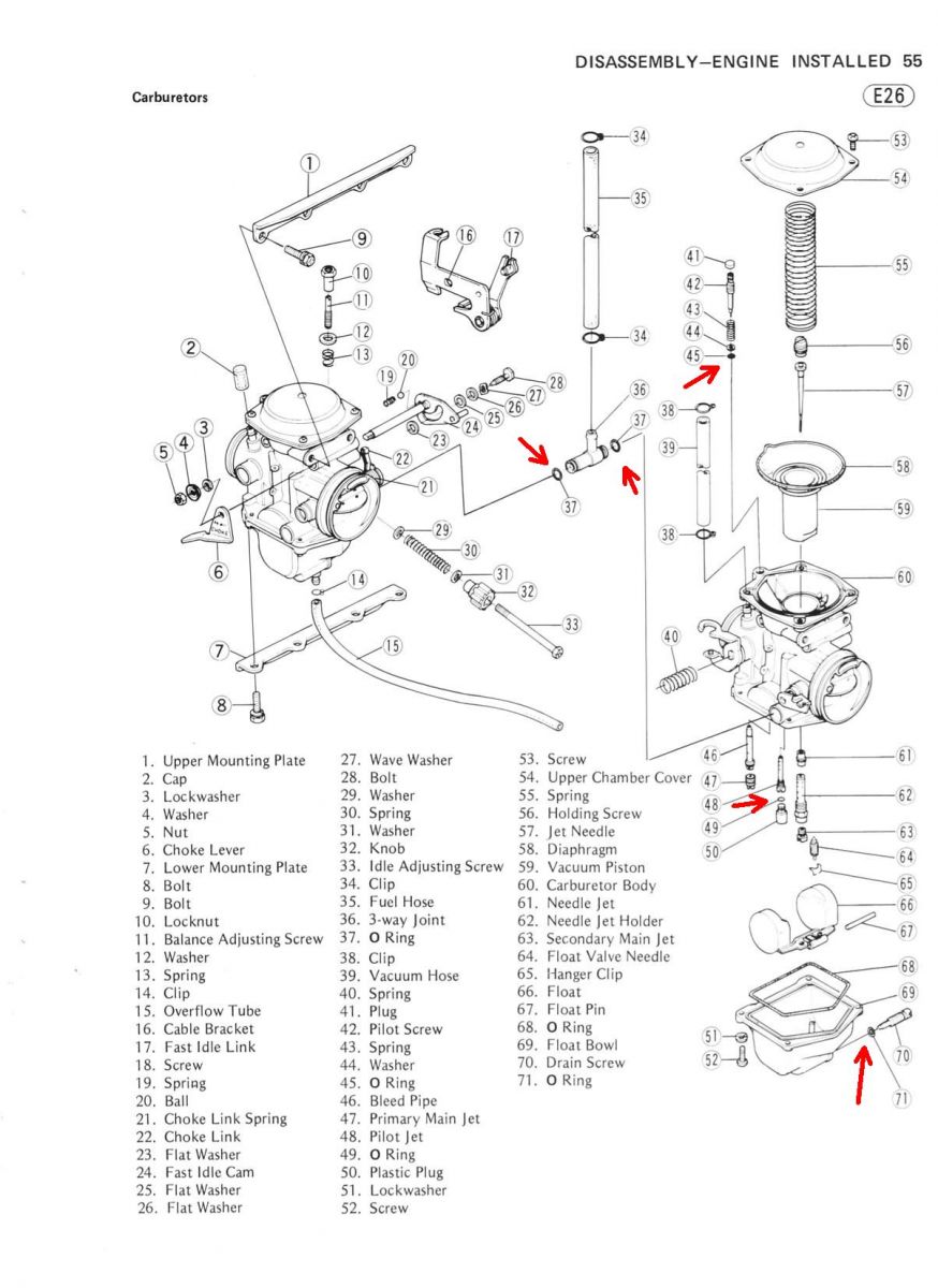

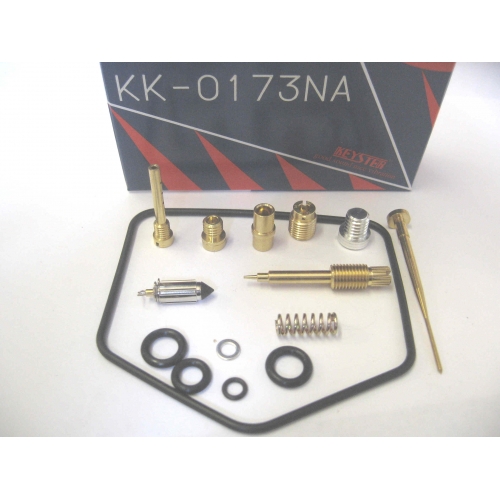

The bike still has issues at idle. I bought carb rebuild kits from Z1 to see what that does. Ihave a few questions on some of the items that came with the kit though - looking for some help...
1. Inside the float bowl o-ring, top right corner (silver screw) - what is that for / where does it go? I can't seem to find it on my carbs (Keihin CV36)
2. I think the two large o-rings are for the fuel t-adapter; smallest o-ring is for the mixture screw (goes w/washer). What is the medium size o-ring for? It seems to big for the pilot needle plug or for the drain screw.

04 Jun 2018 18:57esquare12 wrote: The bike still has issues at idle. I bought carb rebuild kits from Z1 to see what that does. Ihave a few questions on some of the items that came with the kit though - looking for some help...
Some times kits are supplied with parts for more than 1 application.

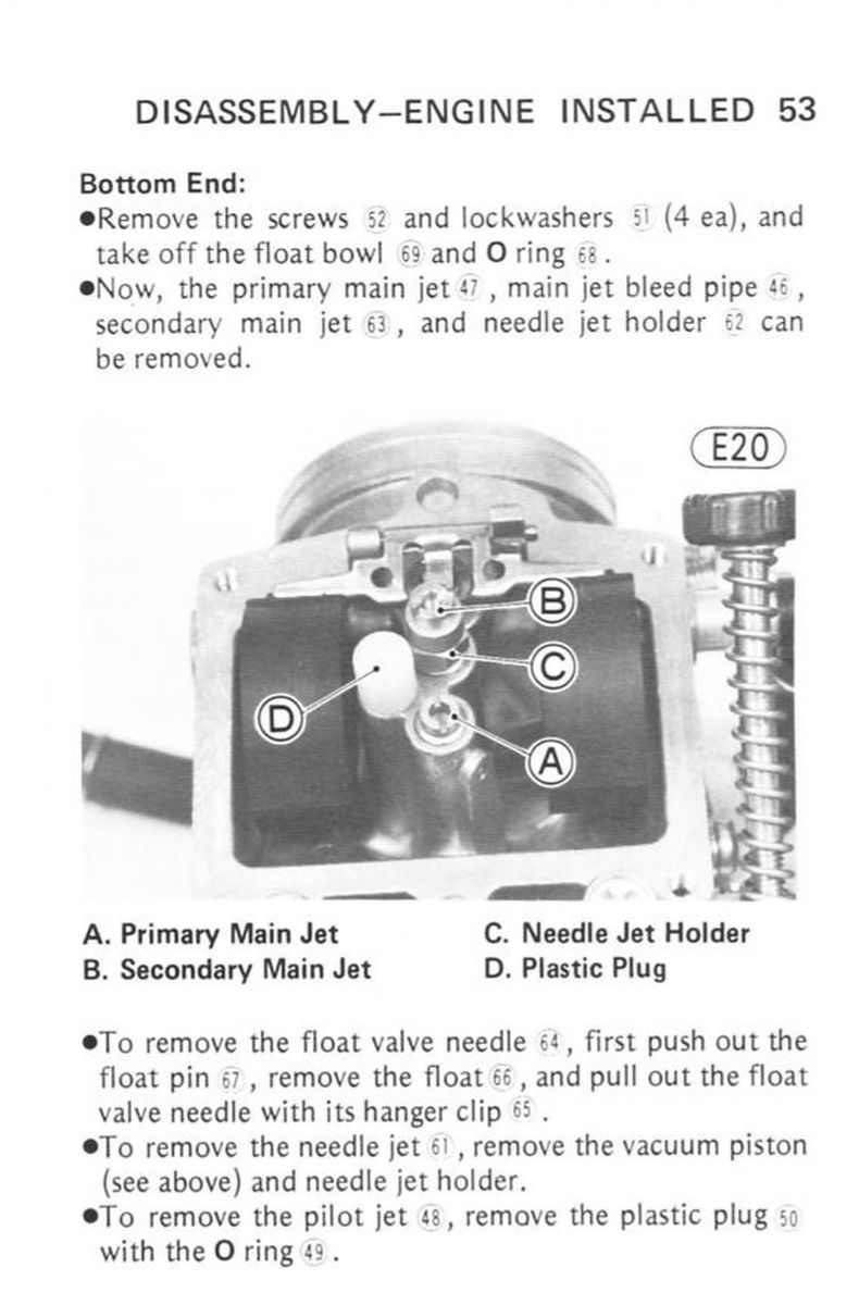

I was hoping to get the pilot jet plug o-ring with the carb rebuild kit but that did not happen. Instead of having to wait a week or more for the stock part I bought the Viton o-ring kit from Harbor Freight, took the smallest one and sanded it down to size with a drill, fine grit wet sandpaper, and some WD-40. Worked fine, no cracks; very tight fit. I went ahead and replaced the pilot screw o-ring as well. Also blew some air through the pilot air jets (inside the rear opening of the carbs). I left all the other stock needles in place as I did not want to bring in more unknowns by replacing a bunch of parts.
While I had the carbs out, I decided to recheck the float levels; had to tweak the adjustment to get the right height (was a bit low). Put everything back together and the bike started on the first crank. Both cylinders are working fine now.
