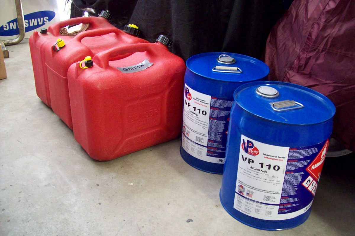

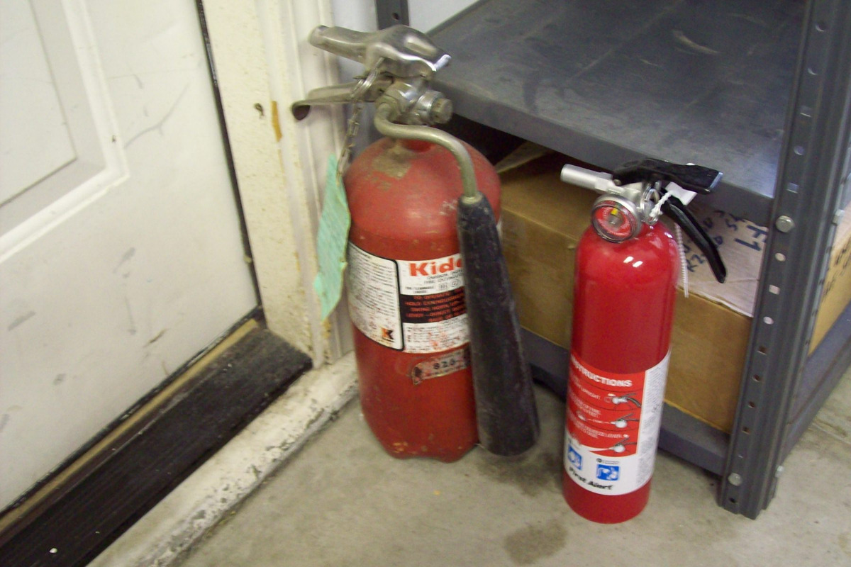

I think you are going a bit overboard on the risk of igniting small amounts of gasoline. I have worked with different fuels in my garage since back in the early 70's. Just use some common sense when working with flammable fuels and other liquids. No open flames, lit cigarettes, or even a gas hot water heater in your work area. Try not to make ant type of sparks when you have open gasoline around. Have adequate ventilation. And just in case have a few fire extinguishers in your area, and know how to use them!!!! You shouldn't have any problems. Just use your head.
I have always had a few containers of race gas in my garage, and at times when I had money, a 55 gallon drum of it!!! If you think gasoline is flammable, you should work with MEK!!!!
Here is whats in my garage right now as far as fuel.
I don't use pump gas except in my car.

We also have three liquid-rated fire extinguishers in the basement. Common sense.
