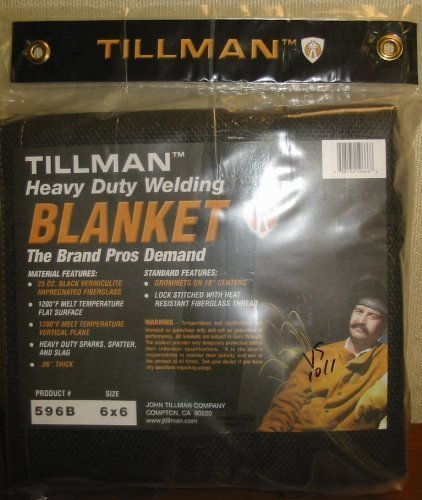

I think I've found a good multi use product that will serve to smother any fire I might start.
How about a welding blanket?
www.amazon.com/dp/B002WPJ04I/ref=psdc_10704399011_t2_B00ECG8JTM
Bill
