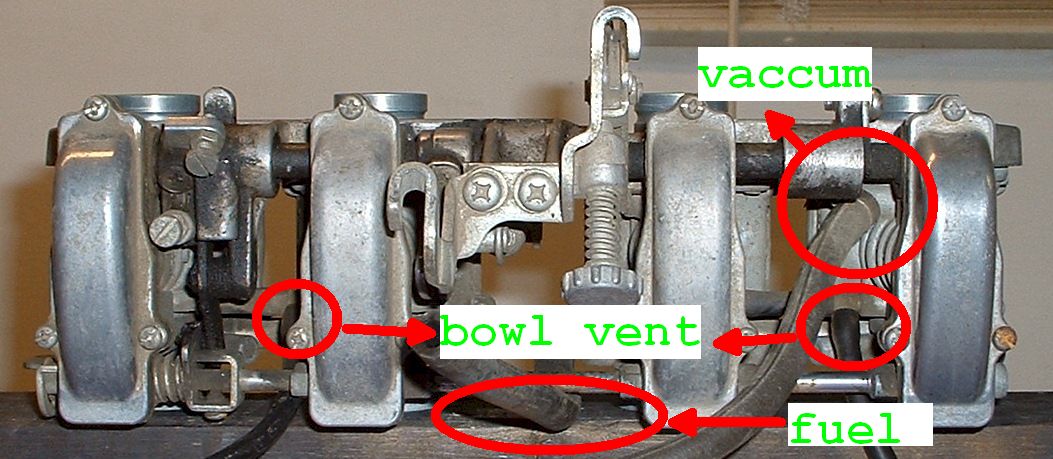

Okay now I'm confused...
This is exactly how my carbs look, which is why I assumed that they were the TK-22

- Posts: 7889
- Thanks: 3262
Re: Correct carburetor mount?
16 Sep 2017 15:53
Do you have some calipers? Measure the ID at the outlet port?
The following user(s) said Thank You: blackumi

- blackumi
- Posts: 48
- Thanks: 4
16 Sep 2017 15:58Nessism wrote: Do you have some calipers? Measure the ID at the outlet port?
Yeah I can do when I get home, I'm at work for a lil while longer.
@Scirocco yeah that's basically a spittin image of what I'm working with

- loudhvx
- Posts: 10864
- Thanks: 1619
16 Sep 2017 21:04 - 16 Sep 2017 21:07
Based on the bike in your avatar and having the carbs in the above photos, it appears someone put Tk22 carbs onto your 1983 Kz550H2 gpz model. You can identify the 83 model by the black area on the side cover, assuming it is the original side cover. Also, the 1983 model has stripes on the bikini fairing. Earlier years did not.
If you are keeping the carbs with that bike, and you need new manifolds, you should look into that link I posted above. Mcren is doing the exact thing you will be doing.
As a side note, the Tk22 airbox won't fit the 82/83 frame, and the Tk26 airbox boots are too big for the Tk22. I suppose there may be some sort of fabrication that could allow for the Tk22 to use the Tk26 airbox, but I haven't looked into it.

Thats an 83 . You might be easier to find a set of cv carbs that fit the bike .

Before you go much further, check the engine number and see if the engine is the original engine. For someone to fit the TK22's, they either changed engines or carb holders previously.
