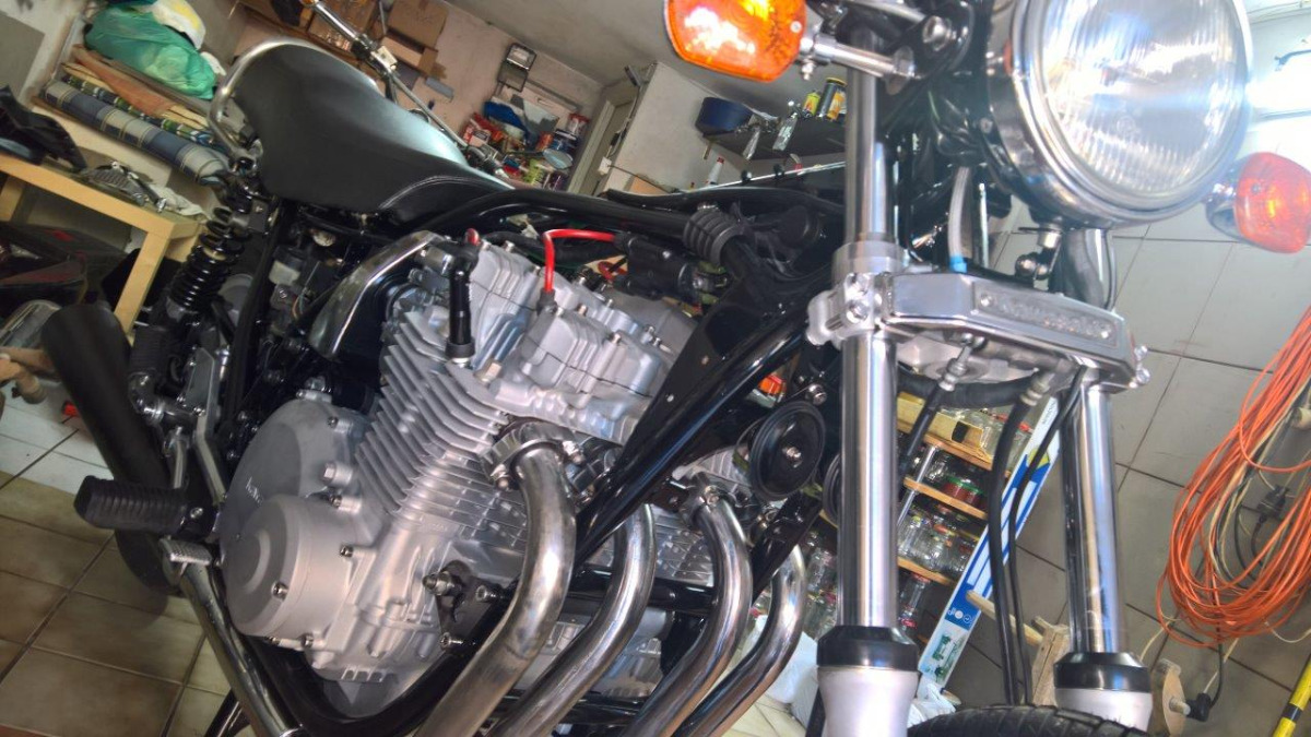

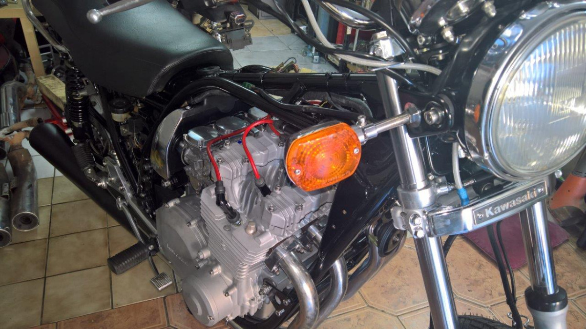

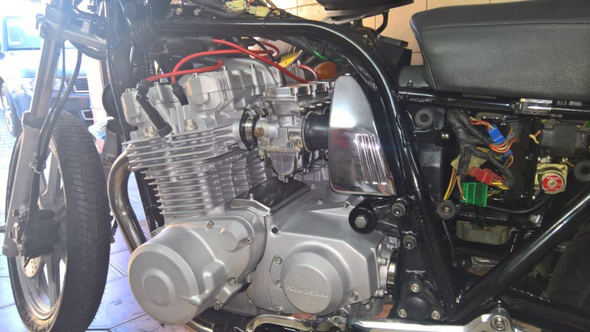

Hi
Just finished (allmost) restauration of my old baby and stuck on carb sync. CArbs were adjusted, cleaned and checked. Engine works unstable and with some backfire. I have tool to synchro but do not know the step by step info. So if someone could help me in that matter that will safe my a lot of try.

And everything eans EVERYTHING. Valve clearance,ignition timing and advance,battery & charging system up to par. Carb synch is nearly the last thing you do. Got fresh fuel? Ethanol free premium is the way to go. It looks like you have the Sucktion -less valve cover. SWEET!!! Those things are rare. I'm running 142.5 mains & the larger pilot jet. It's a little rich at idle, but that's it.
