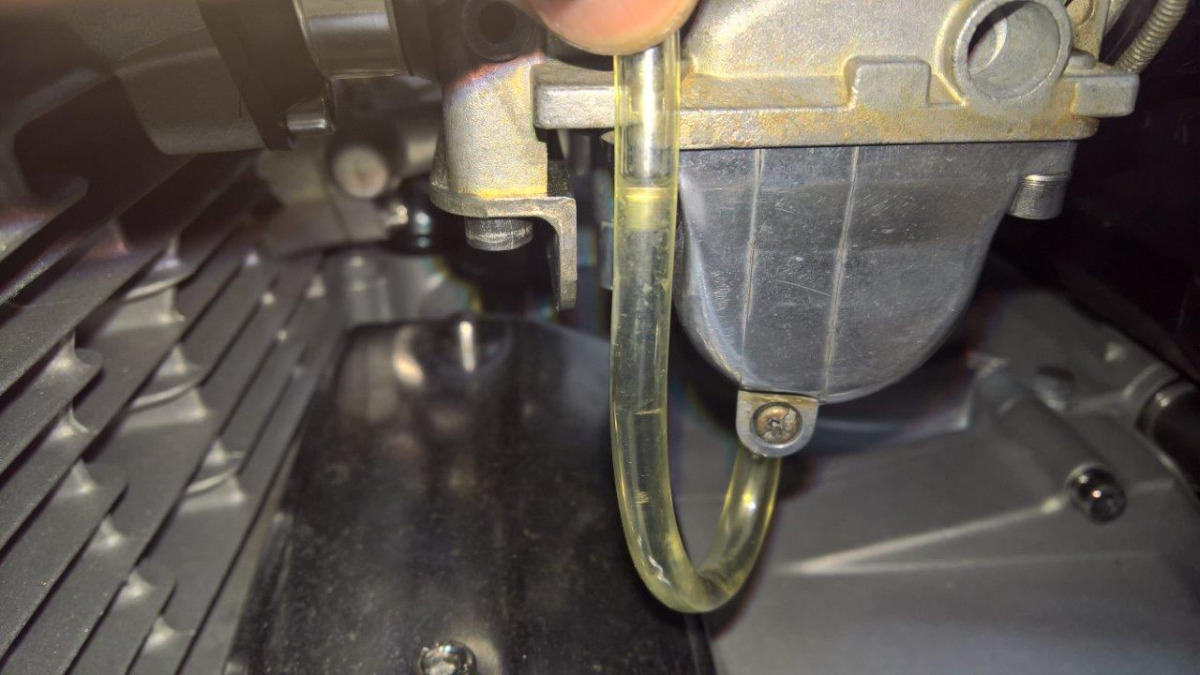

I checked the fuel level in carbs and looks ok in each of them, look the pics.

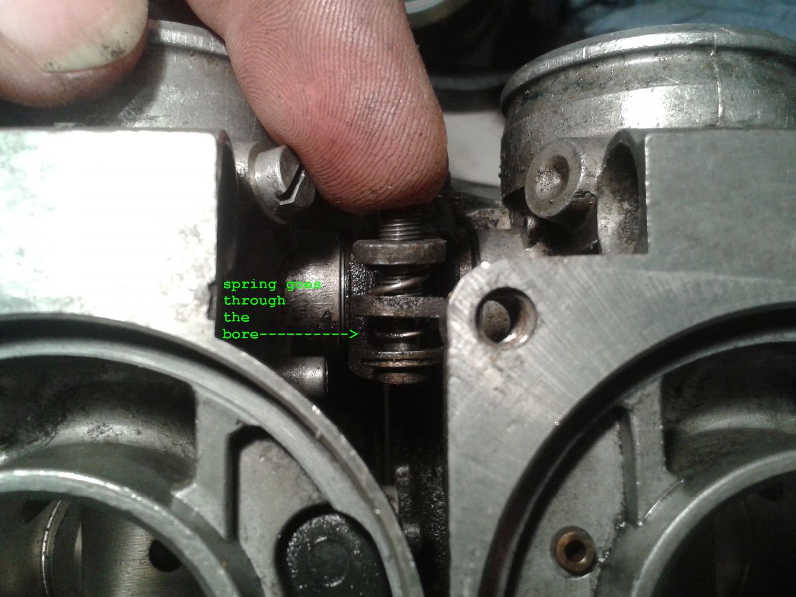

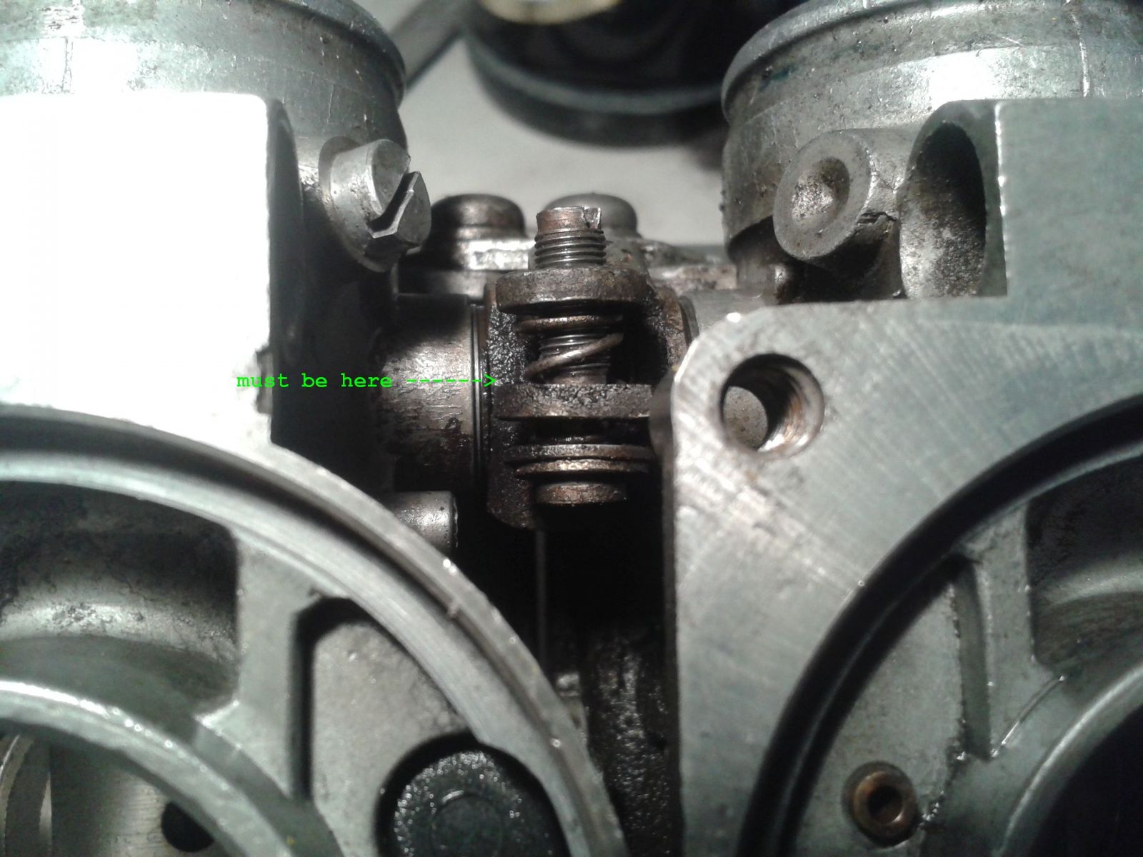

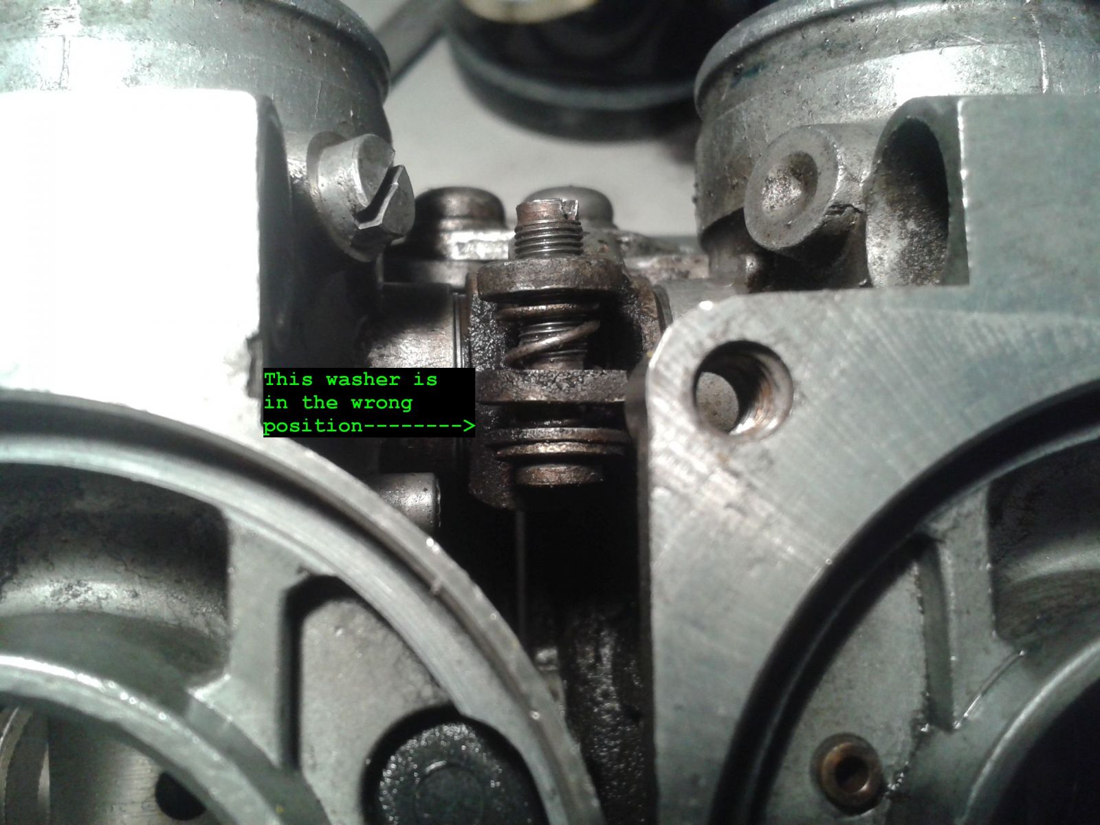

- Posts: 4420
- Thanks: 2269
Re: Kz 1100 carb sync
02 Aug 2017 16:48
If a carb sync looks impossible check adjust screws for a mis-assembly.
Found this after a carb rebuild by an so called specialist.

Is the fuel level showing just above the bowl-drain screw in your picture? It appears to me too-low, or maybe there is air in the tube distorting the view. :whistle:

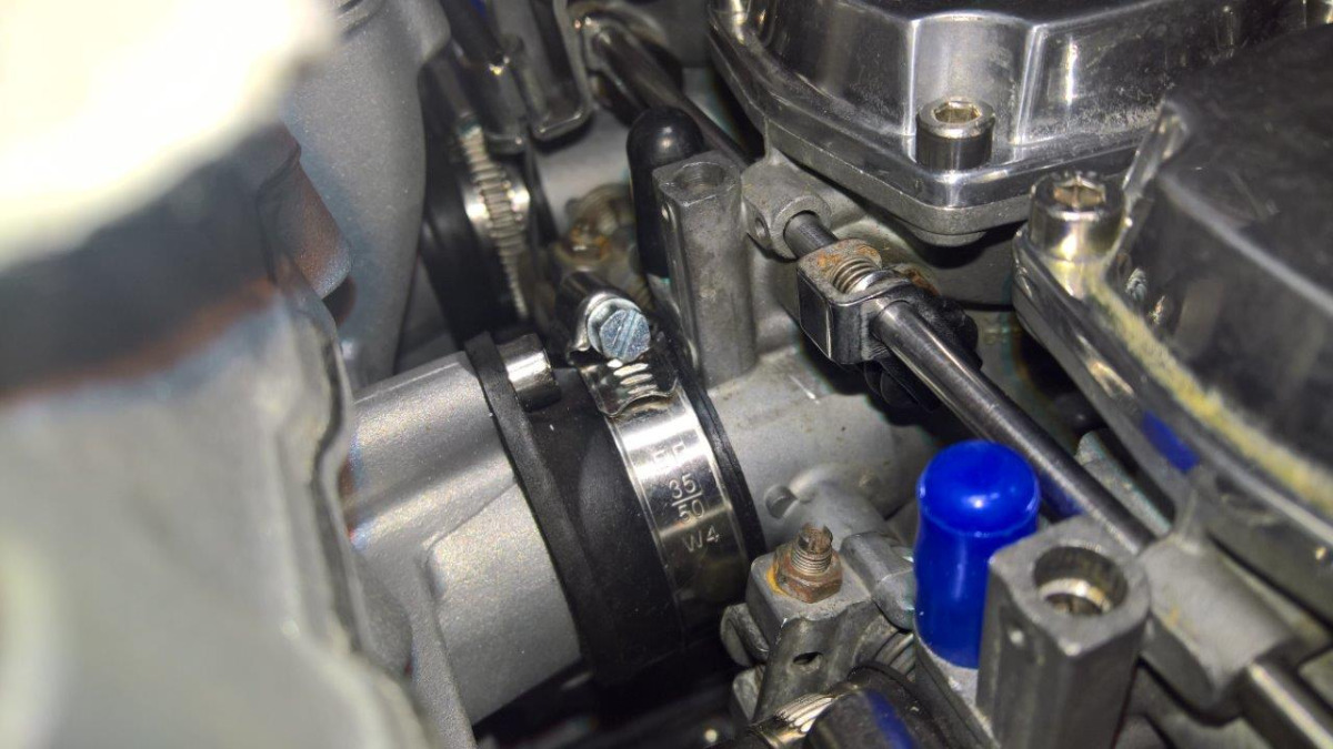

BTW, thanks for posting those great-quality photos.
Also, your carb clamps and blue silicone vacuum plugs are awesome choices. I use those same clamps with protective inner-bands, and will never go back to the chincy stock type.
