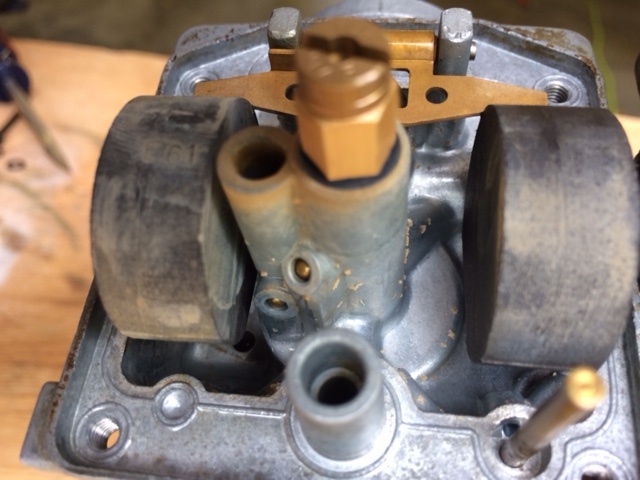

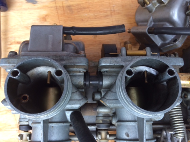

This afternoon I got the carbs out. I took a few pictures along the way and wrote down what I did after each section. Hopefully this reduces any errors when I put them back together again. When they were off, I opened the float bowls on each of the four carbs. Removed the main needle and jet needle one by one, and sprayed it with carb cleaner and compressed air. During reassembly I replaced the O ring on the drain screw.
Should there be anything else I do while they are off?
I noticed carbs 1, 2, and 3, the air intake had blackish residue along the walls. Carb 4 didn't have that. Carb 1 did have some type of mineral deposit build up which I cleaned with carb cleaner and a brand new tooth brush

The bike is back together again! I swore the most putting the boots on between the air box and carbs. Getting those in just right was a hassle! Thankfully it fired right up.
To address the three major issues:
1. Putting the tank back on no fuel leaked. Makes me wonder why fuel leaks after the bike has run for awhile, but eventually the petcock does it's job
2. Dies when I come to a stop at a stop sign. I need to ride it to see if this has been fixed. It's a rainy afternoon here
3. Idles poorly. With the choke around 20% it sounded smooth and was a little higher RPM than idle should be. I put the choke off and the rpm's were so low the bike would have died. This might be due to the engine simply not being warm enough yet. I'll have to go for a ride to really test things

02 Sep 2017 15:32pa317 wrote: ................... I put the choke off and the rpm's were so low the bike would have died..........
Did you adjust the throttle stop screw so it idles at about 1,000 rpm? Ed
