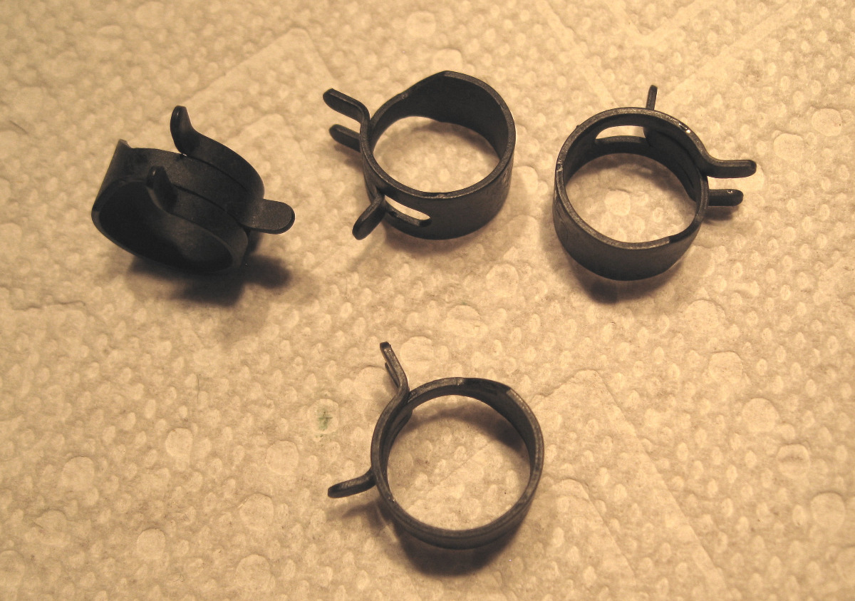

For clamping the hoses I use 5/16" spring clamps (see 1st image below). They are a million times easier and quicker to use than the screw type. Some auto stores sell them or they can be easily found on eBay.

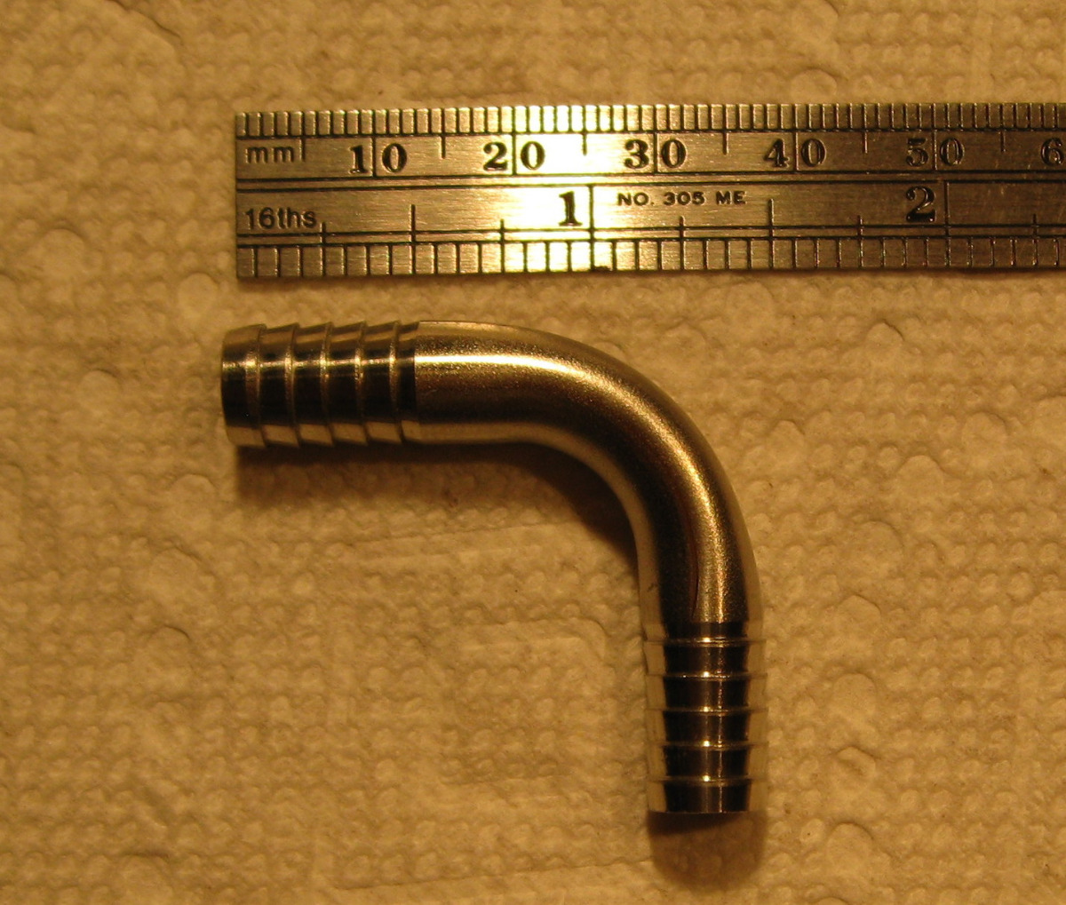

I use a Golan Super Mini 5/16" fuel filter; see "70-312G 5/16 Barbed Fittings” at www.golanproducts.com/filters.html#filters-mini for specs. (See 2nd image below). They are not cheap, but one will last a lifetime; I got mine from ronayers.com. They use a stainless steel filter element that can be cleaned. They filter out very small 10 micron particles but still pass fuel at a rate of 6 gallons per minutes – MORE than enough for any bike. They are very small so they fit well under the tank. Also, I used a 5/16” stainless steel elbow to make the bend from the tank to the carbs so there is zero chance of the fuel line pinching (see 3rd image). I got it at a place that specializes in propane supplies.
