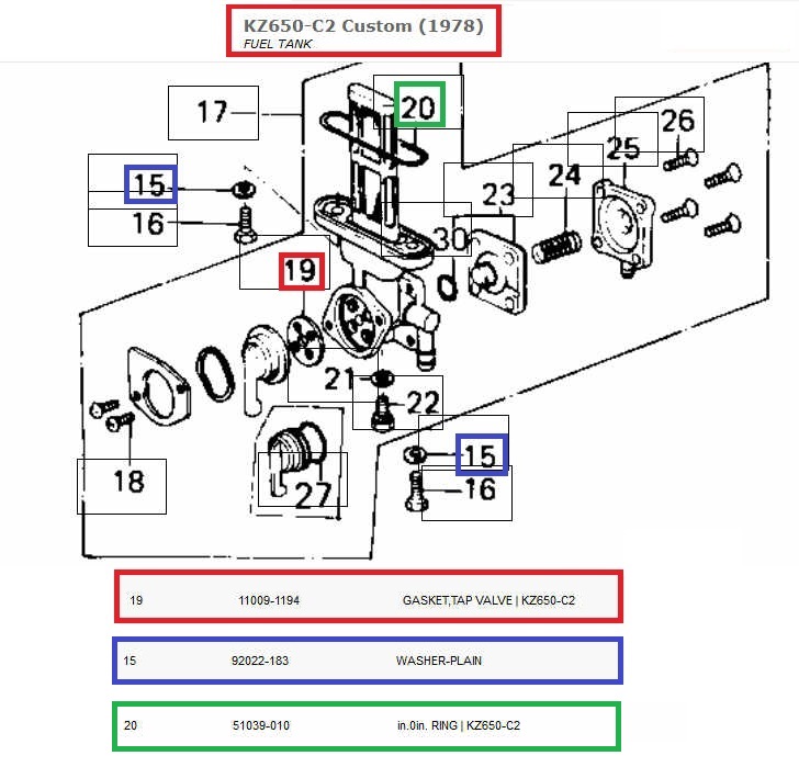

Where is the petcock leaking?
If it’s leaking through the fuel or vacuum lines it might be because the part marked #19 (Kawasaki part number 11009-1194) in the diagram below commonly fails. You may want to replace it and see if that solves the problem. If you search eBay using 11009-1194 as the search criteria you will find there are many of them available there.
If it is leaking where it attaches to the fuel tank it could be that a PO used metal instead of nylon washers marked #15 (Kawasaki part number 92022-183) or that the rubber O-ring marked #20 (Kawasaki part number 51039-010) is damaged. Those washers and O-rings are also readily available on eBay if you search by part number. Ed

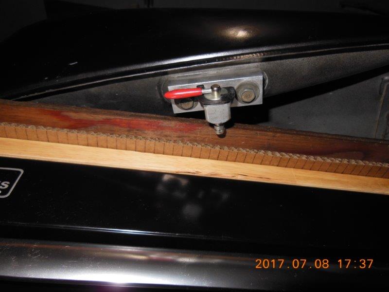

No eBay APP ID and/or Cert ID defined in Kunena configurationToo bad this one is a little different?
It is real nice. Even the diaphragm rubber is still good.

There was 2 different vacuum fuel taps used in 1978. Look at the picture Ed posted, and if your diaphram looks like the picture, you can buy the diaphram for around $13.00, a couple additional orings, and there you have the rebuild kit. All parts used for 30yrs, so all available to order easily. If your vacuum petcock diaphram looks different than Ed's picture, that petcock is way long ago obsolete, and no parts to fix that one. I'll have to disagree on the vacuum petcock being junk, the manual one was junk for sure, the vacuum one works fine.
