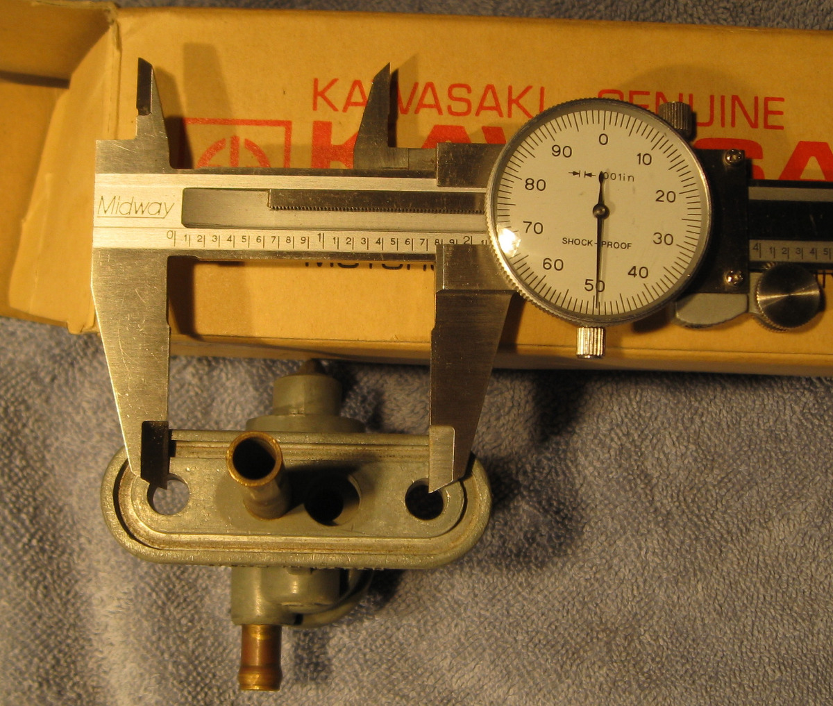

Do you know of a manual petcock that will fit the 1978 KZ650 C2 ?
I'd love to get one!
Jake
Jake
- Posts: 15339
- Thanks: 2833
Re: 1978 KZ650C2 petcock woes
09 Jul 2017 15:08
Here's a picture showing the spacing for the mounting bolts on the 1977 K650 manual petcock. If the spacing is the same as your 1978 petcock spacing a petcock from a 1977 KZ650 will work, but finding an unmolested or new one might take time. There was a place in Germany making exact replicas, but I haven't seen them offer one recently. Ed
