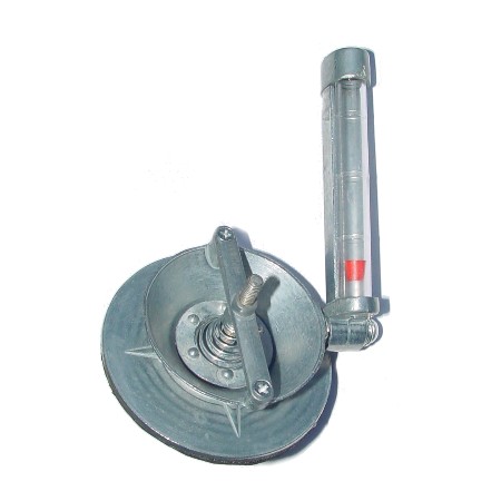

Here is your carb sync
have fun

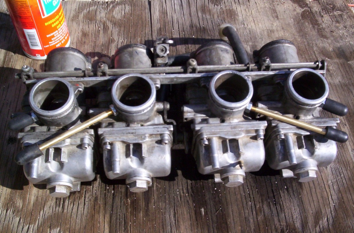

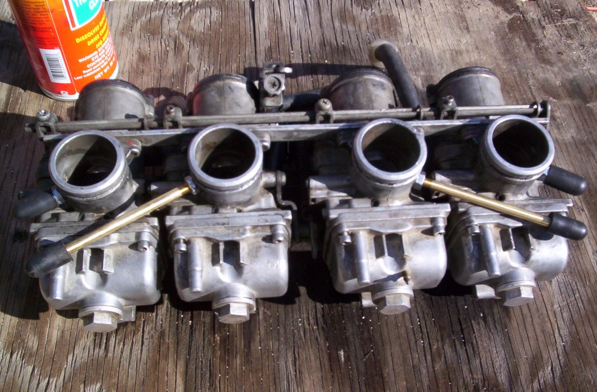

Here are some pictures. One is on the left side and the other is on the right side of the motorcycle

Your carbs are for a 2-stroke engine and have no vacuum plug for carb sync.
First you have to sync both throttle cables to get the same movement and high of the throttle valve.
I remember some one here in the forum goes the same way on a 440

Those are vents. You may have to make some ports. On my 350 Honda I balanced them by using my hand to measure the pressure coming out of the pipes.
