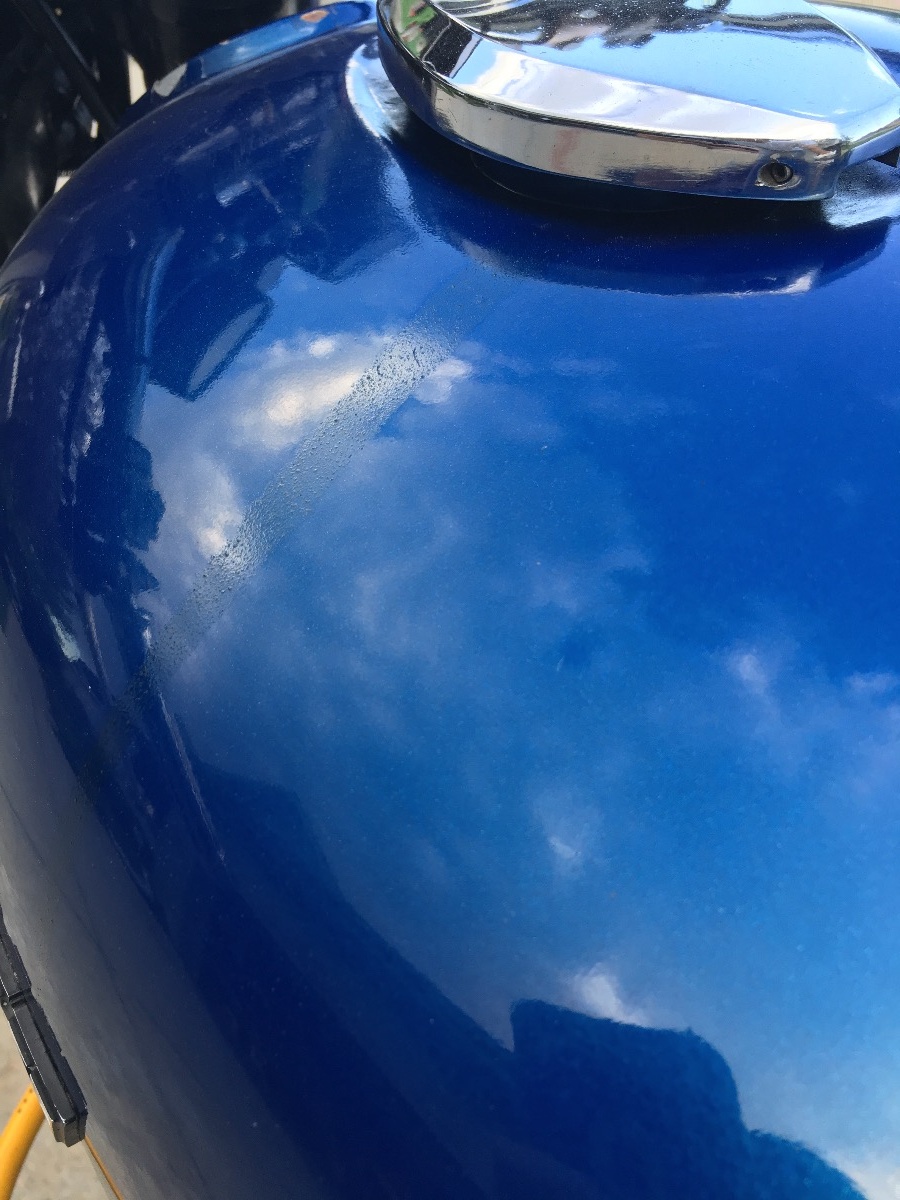

I replaced my fuel gasket a while back because the old one was shot. Ever since I replaced with a new rubber gasket on the fuel cap, I get what looks like residue running down the sides of my tank after each fill up. The residue will return after each ride or if the bike is sitting in the sun until the fuel gets down to maybe 1/2 or 1/3 tank. Any ideas on what this is or why it is happening?

I'd run the tank empty then fill it to see what happens. Did you clean out the breather passage in the cap?

I'm probably half way through the seafoam tank. Will post back after I refill with any changes.
Breather passage?
I removed the old gasket and put the new one on, I scraped off some rust but nothing else.
Edit - Looked up gas cap breather and nothing looks anything like the cap I have. I did unscrew the part mounted on a spring to be able to get the gasket around the lip, then screwed it back in place.

You might want to check it out. I made the mistake of filling it to the top and ruined my new paint job. Got behind the badge and created gas filled bubbles in the paint.
