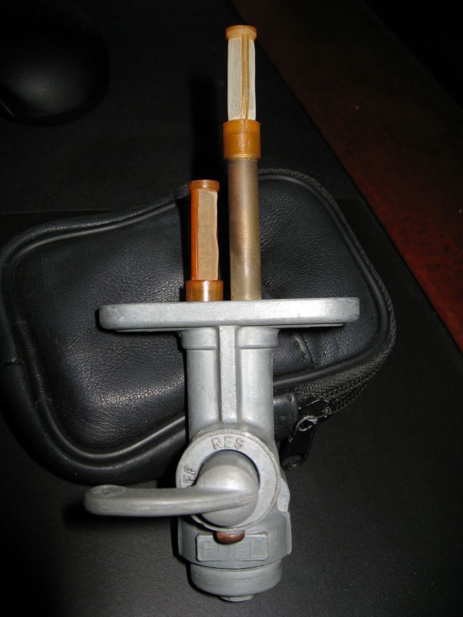

I know this is from a different model (my KZ650-C1), but here's a picture of my stock petcock. You may want to compare it to the one you have. Ed

Why cut the line? This change nothing to your problem. Disassemble and clean up your petcock.
The long brass line with filter is for the "ON" position of the petcock.
If the fuel level goes under this line you have to switch to "RES" position,this is an indicator function like "hey you run out of fuel".
Remove this cap and check the filter is clogged.

My new petcock looks like yours Ed, but the copper tube is taller and as such the filter that fits on top is much taller than the res filter. I doubt the new one with the filter will fit at all without cutting.

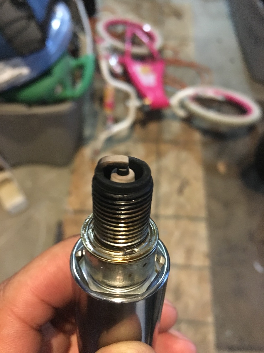

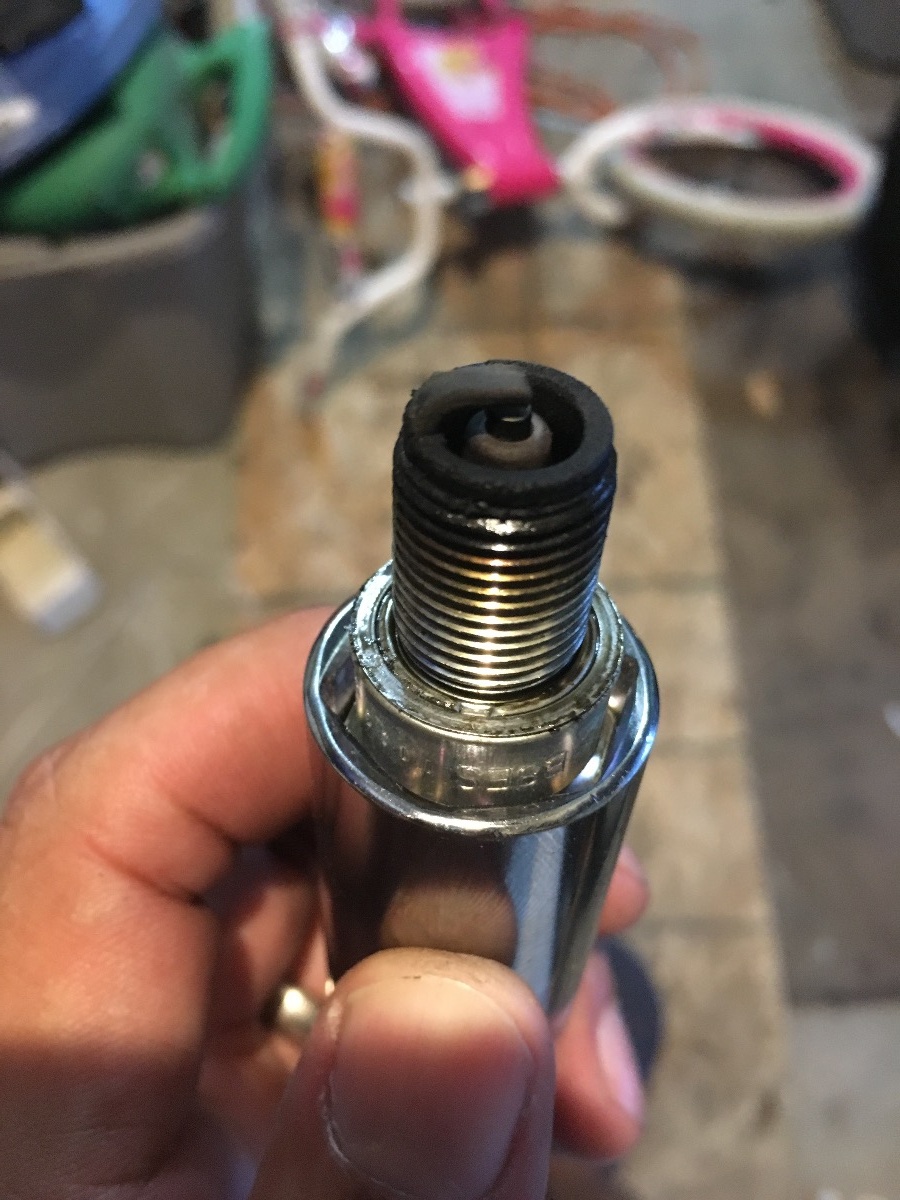

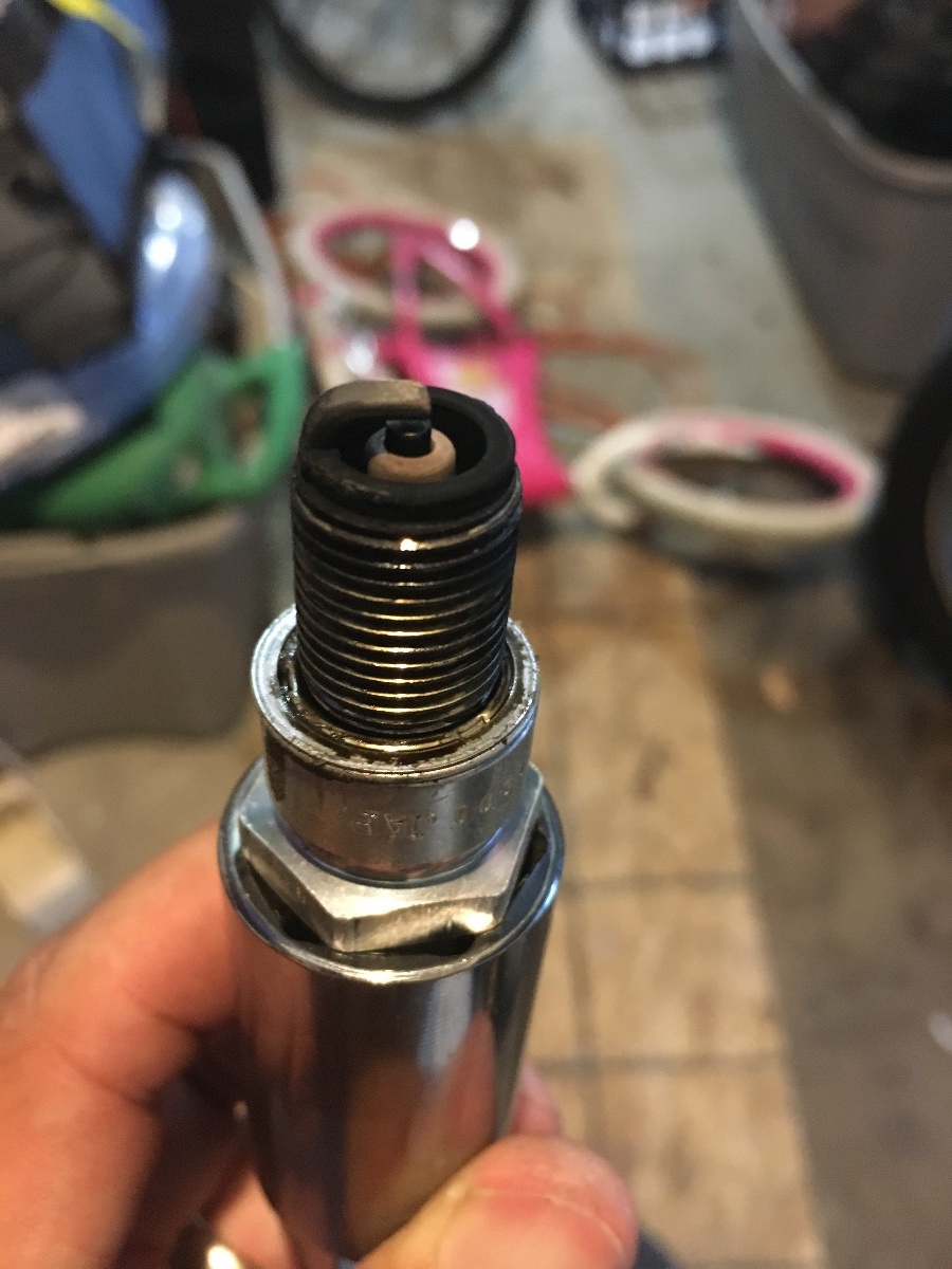

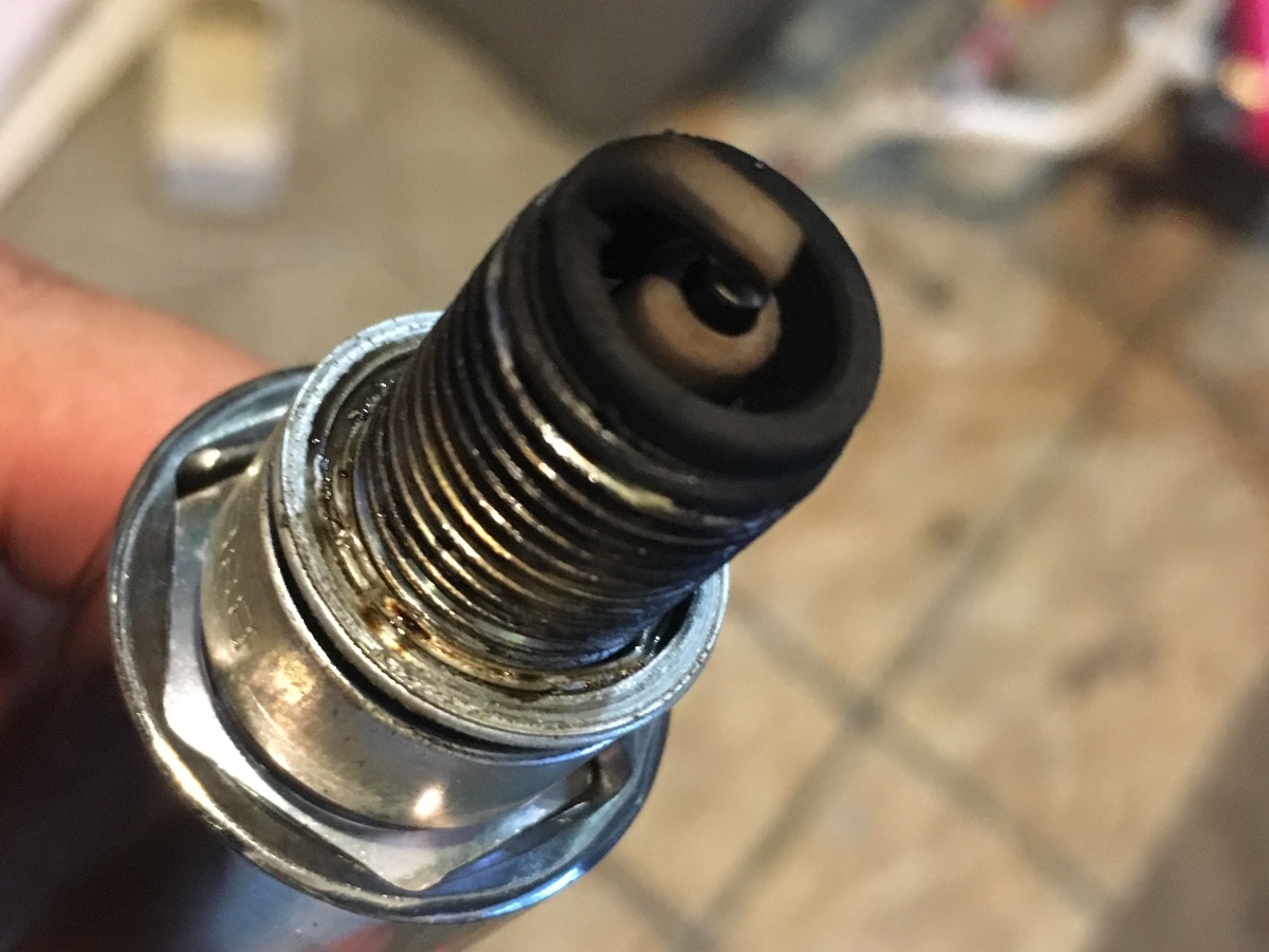

I do have pics of my sparkplugs. Here they are 1-4.
