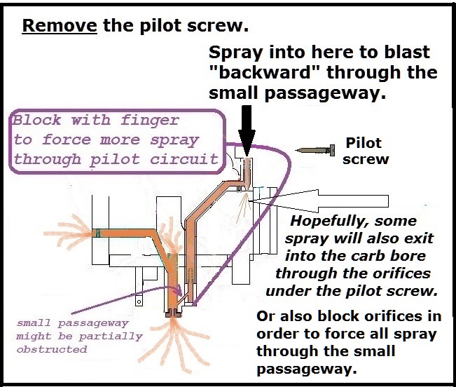

27 Apr 2017 08:43If not already done, need to assure a perfectly clean and clear pilot circuit that that ends with fuel mixture entering through orifices into the carb bore..
The following user(s) said Thank You: GPz550D1, Skiprrdog

--Patton-- Thanks for the excellent drawings. Ill be looking very closely at the pilot circuits, and actually the reason I decided to take the carbs out again was that after reading a few carb posts on here, I realized that that I did not spend enough time (or actually any time
) ensuring that the little wells in the float bowls were clear. Dipped the carbs, etc, but did not spray cleaner into the little openings and maybe run a small wire in there. Considering that they were probably the filthiest carbs I have ever seen...
