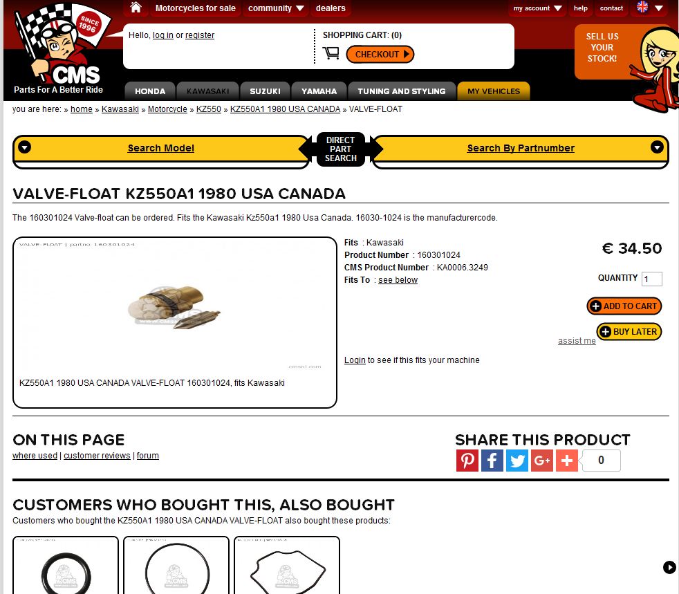

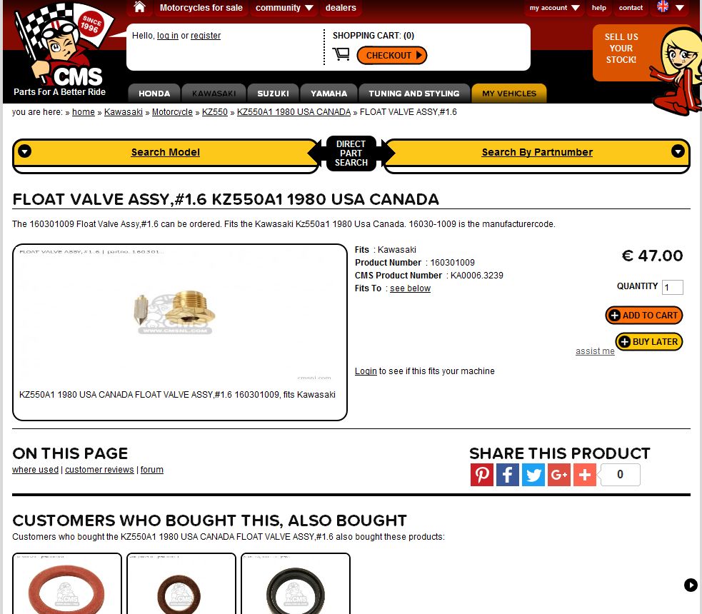

Are you sure you have the right needle valve?
www.cmsnl.com/kawasaki-kz550a1-1980-usa-...odel15477/partslist/
Fits the Kawasaki Kz550( A4 )1980 Usa Canada. 16030-1024 is the manufacturer code
Fits the Kawasaki Kz550('80-'81 A1/A2/A3) 1980 Usa Canada. 16030-1009 is the manufacturer code.
