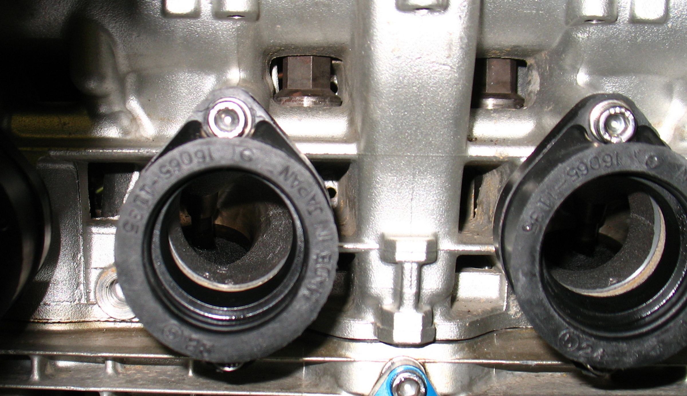

19 Jan 2017 09:28swest wrote: Could be valve guide seals. Next time you have your carbs off stick your finger in the intake ports and see if any oil is on the valve stems.
Couldn't reach in that far, but the stems looked ok. There is carbon (I think) on top of the valves, some of which may not have been cleaned off before installing the head.

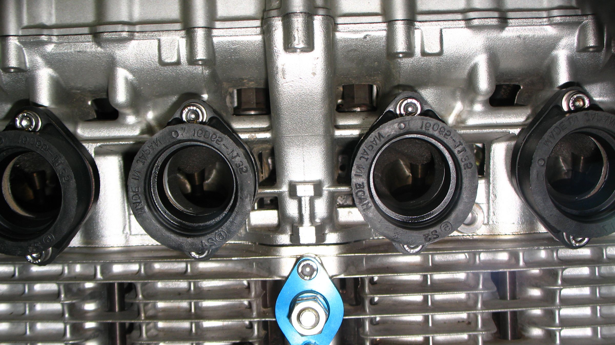

If you can zoom in on the second pic and look at the deposits on the valves, will that tell anything. I realize that fuel coming through tends to clean the intake tract, but wonder what that crusty looking black crap on the valves is. What is best to use to clean that stuff off while the bike is being ridden?

With bad valve guide seals my intakes looked like that. The exhaust was NASTY. Think about it this way, the air/fuel coming in will wash away the crud but the oil is more viscus so it clinging on the hot valves will leave those deposits. Oil being in the mix will effect the jetting a little. I had to go down one jet size so the plugs wouldn't foul. Mine were really bad, yours not so much.

They look in the park to me with 1+2 a little darker than 3+4 but that may be because you drive on the wrong side of the road and get a little more wind on your right from passing vehicles. :laugh: Seriously though, I think you are very close and I would have it out on the road showing off that nice shiny engine cover you have!

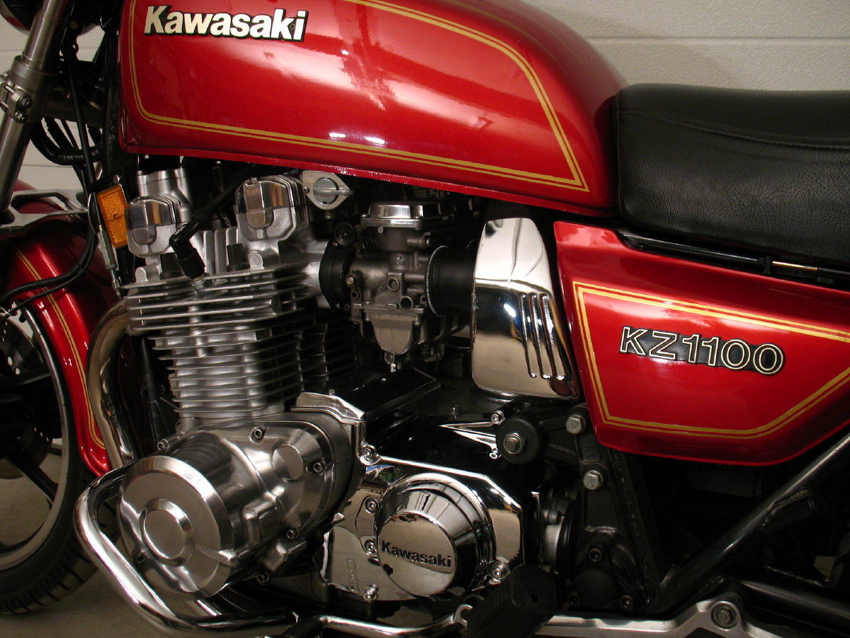

Took the pic immediately below on 01/15/2012 just after it was installed, and boy was I geeked.
1839 days ago :ohmy:

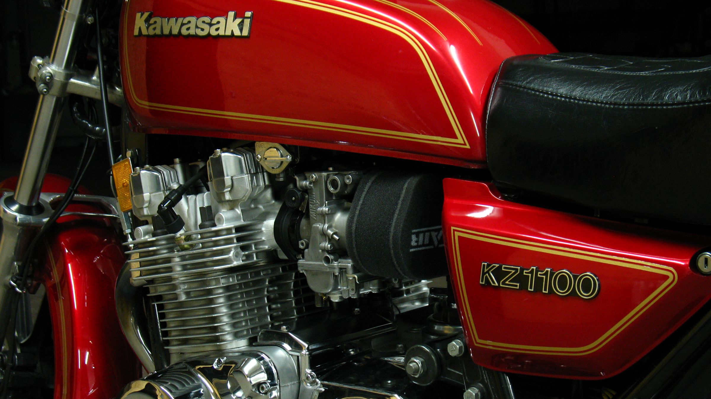

Maybe this idea is krazy, but I'm now thinking of adapting the carb side of the air box to incorporate the 30mm aluminum velocity stacks and foam filters. :blink:
There would be enough clearance space behind the 30mm stacks for easy removal, leaving the modified air box in its original position in the frame, while the carbs are serviced or removed. The Ramair filters may be adaptable to form a seal against the air box face, covering one large opening cut into each side, eliminating the original tiny air boot holes.
Note how the angular shape of the Ramair foam filter is similar to that of the decorative chrome cover on the air box.
They could mate up nicely.
