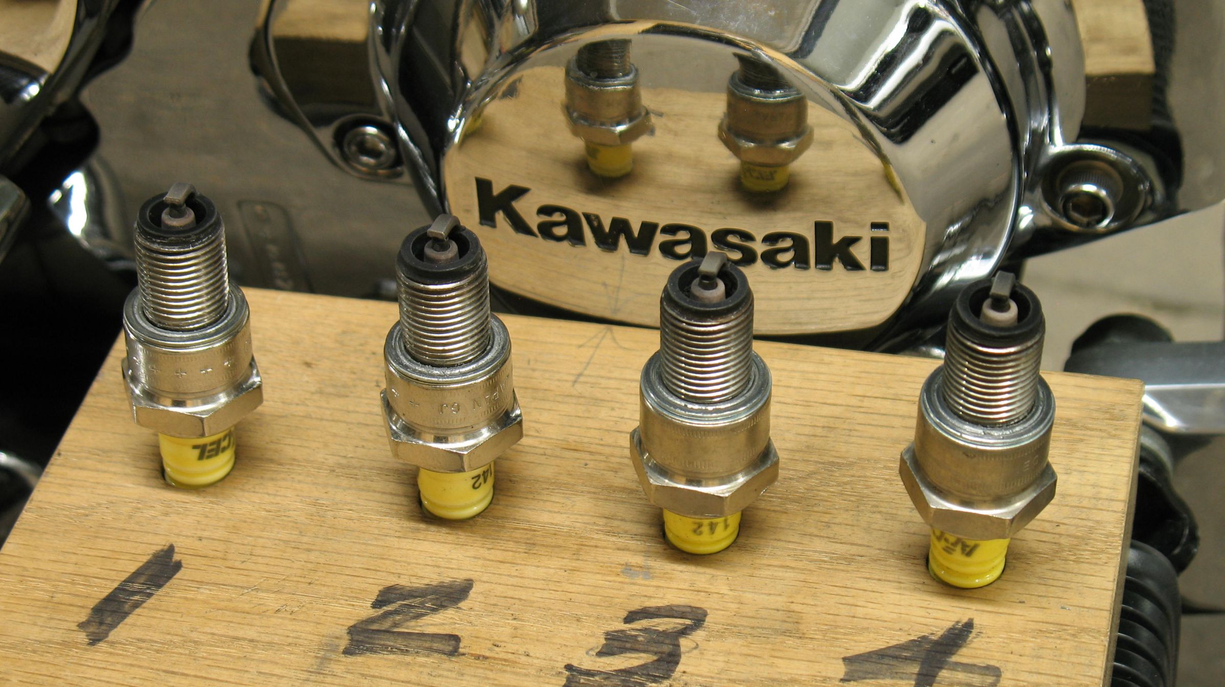

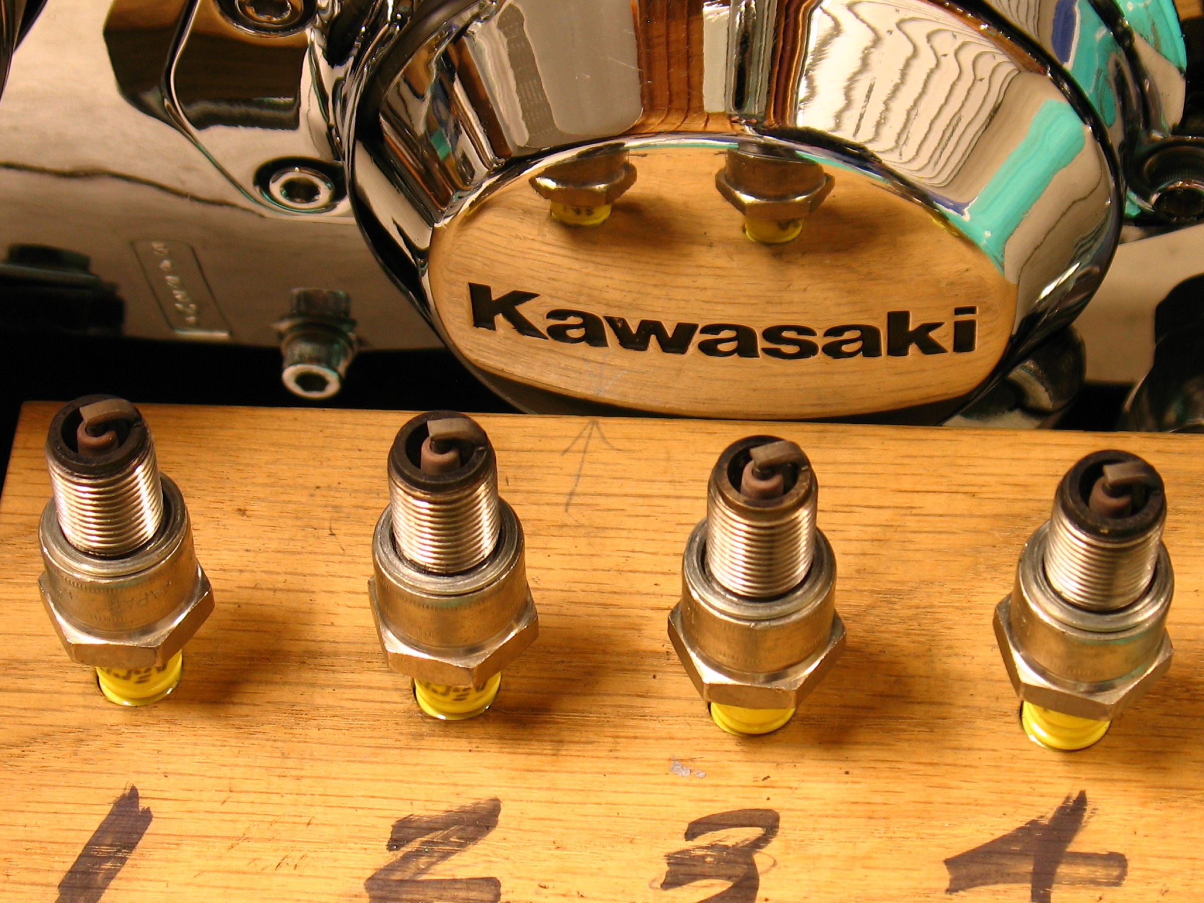

09 Jan 2017 18:44daveo wrote:Nebr_Rex wrote: Do you have pics of your plugs when running individual filters?
Are you saying a plug will be colored differently on one side of the electrode
vs. the other?
Ok, these pics were taken with the RS36 carbs, which I no-longer own. Also, I was using Accel U-groove non-resistor spark plugs (w/resistor caps) in both sets of pics.
5/21/16 with the air box:
Why is there more carbon build up around the bottom of the 2 outside plugs?
And more even build up in the bottom 2 pics?
I don't know the answer to that. Could the carbon buildup be attributable to having the fuel mixture too rich, or because I was using RS36 carbs which a couple members suggested were too big for my application?
Or could it be from burning oil? I'll go through a quart in 750 miles or so...
I ride a lot with the engine singing around 7 to 8 K on the tach, and figure that causes more oil use than babying along between four and five.
Perhaps I get a little rough with her, but she always begs me for more, and sure loves that revving feeling. :woohoo:

09 Jan 2017 21:18
Could be valve guide seals. Next time you have your carbs off stick your finger in the intake ports and see if any oil is on the valve stems.

09 Jan 2017 21:38swest wrote: Could be valve guide seals. Next time you have your carbs off stick your finger in the intake ports and see if any oil is on the valve stems.
I didn't think to look in there when I had the manifolds off over the weekend...aargh.
Before installing the low (9000) mile head in the Spring of 2015, I had it checked over and the guy touched-up the valves/seats, and installed new Viton seals on the stems at that time.
I've put well over ten thousand miles on it since that top-end, if that say's anything.

10 Jan 2017 03:56
Or is it because the design of the air box.
The center 2 cylinders have a straight shot from the air box plenum.
Versus the dog leg for the outside cylinders.
Sport bikes do not have that problem with a perimeter frame.
