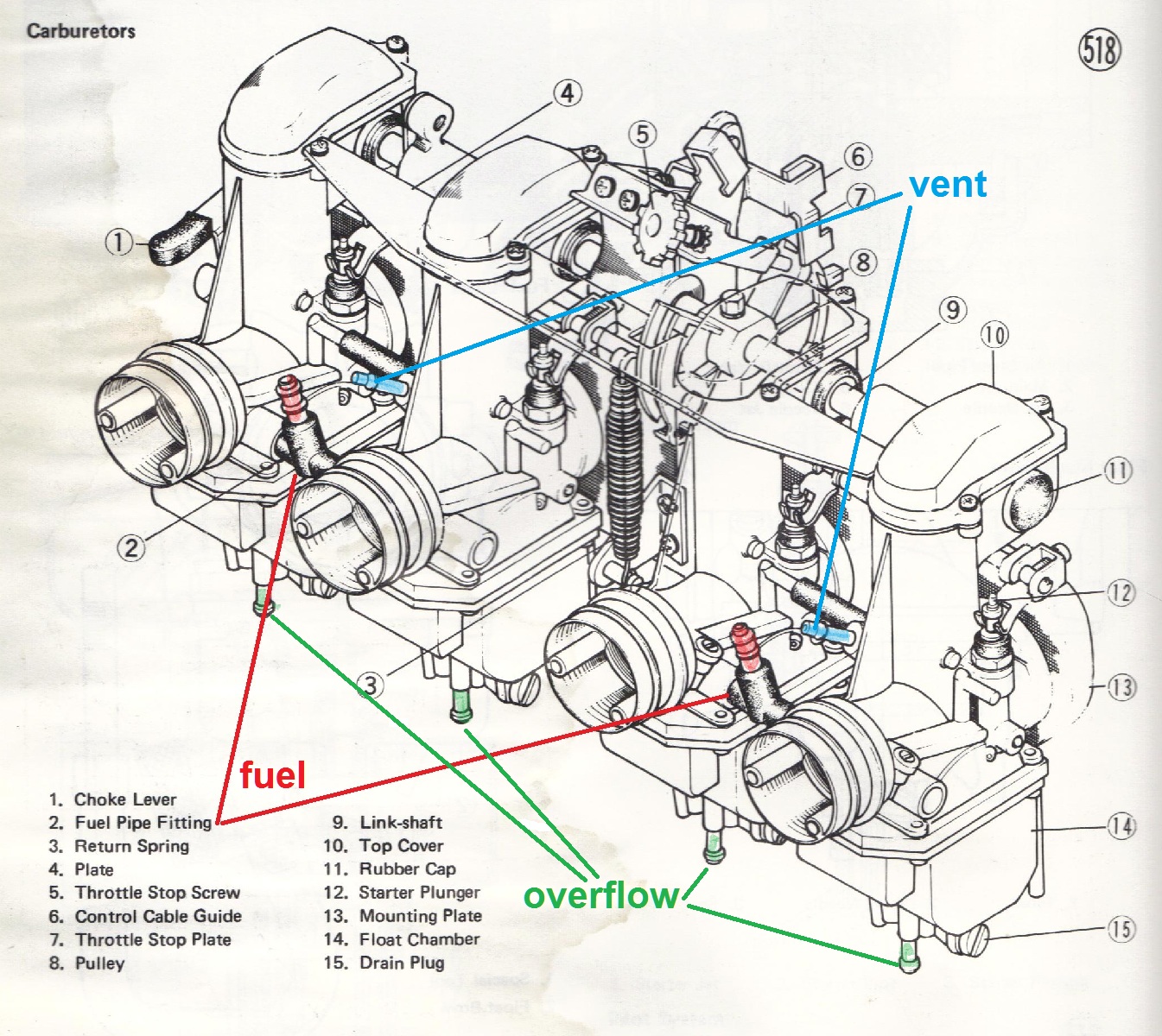

I suspect the stock carbs have two "fuel pipe joints" which is Kawasaki's part name identification for what may sometimes be more commonly referred to as a tee fitting.
Stock fuel pipe joint

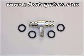

Optional part with o'rings
If going to the trouble of separating the carbs enough to remove the tee fittings, might want to consider going ahead with brand new parts instead of the Teflon tape wrapping method.

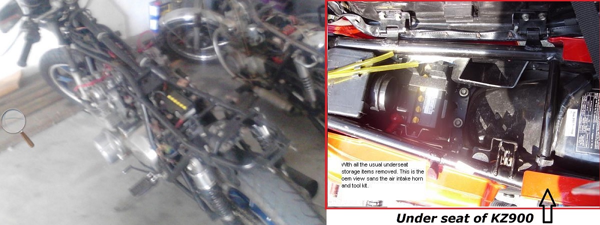

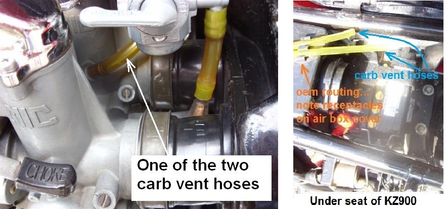

I suspect that Katums doesn't need these pics, but here they are for other viewers that might be interested.
The vents exit to open air. Stock configuration is through hoses routed to underneath the seat where the hoses are held in place by a clip that's located on top of the air filter cap.
The pics don't include the air filter intake silencer, which has been removed to gain additional under-seat storage space.
