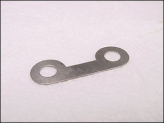

Your going to have a hard time syncing those carbs with out the carb linkage washers. Your pictures show they are missing. These are huge in keeping carbs running together. I believe these are a large reason Mikuni changed the system in 76. I usually use 2 per side. You can get them at Z1 enterprises. If you ever want to trade those carbs off for a set of 34 CV that came on that bike let me know. I may even have an airbox to go with it.

Link plates will help for sure and also use vacuum gauges on the carbs with the gaskets and tops installed. Smoothbores are adjusted with the tops installed as well as apparently there is a chance for draw around the slides if not covered throwing off the accuracy of the adjustments.
