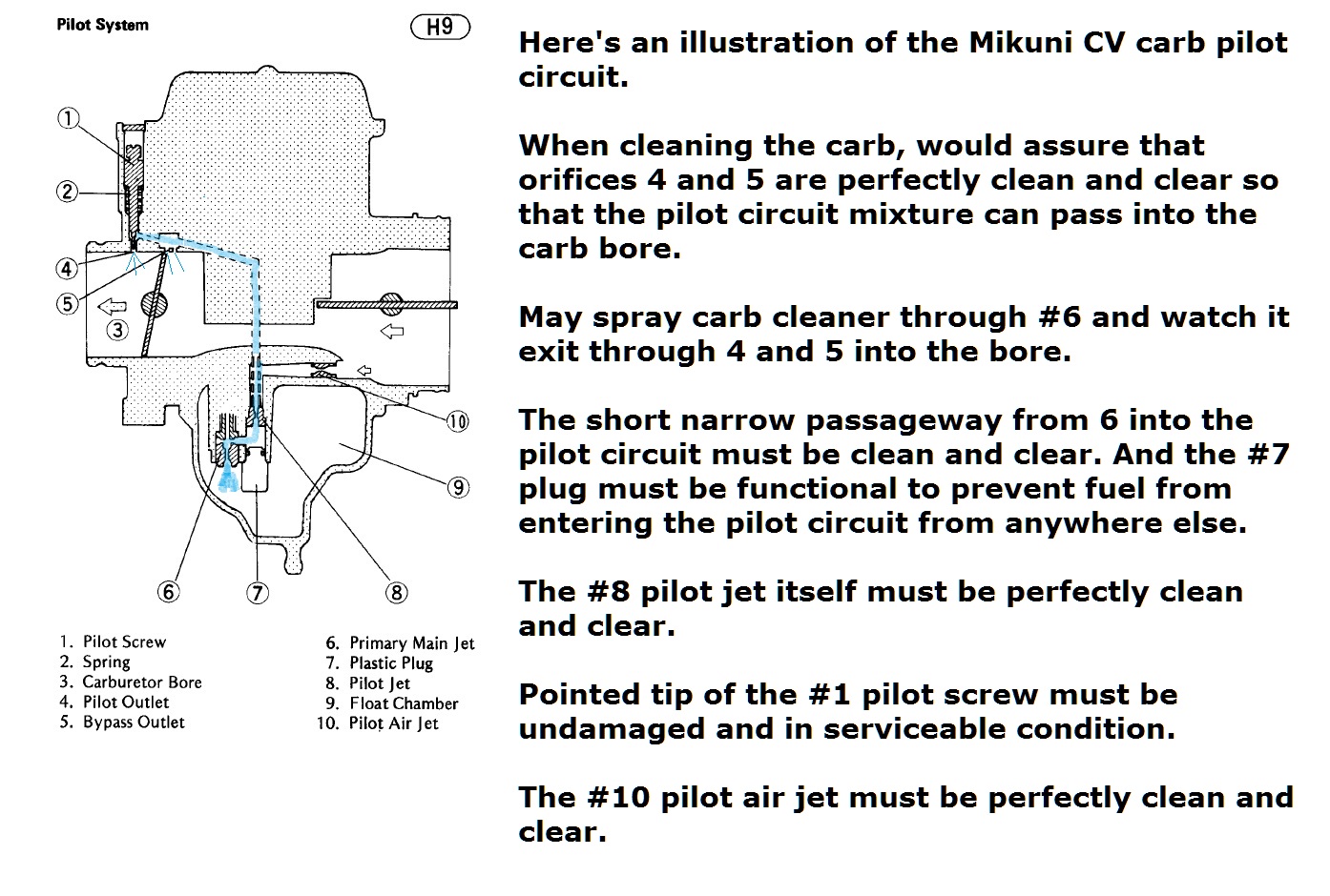

Momentarily running (combusting) via assistance with starting fluid spray -- but then shutting down -- indicates failure of fuel mixture being received from the carbs. Which usually means imperfectly clean pilot circuits and/or improper cold start procedure (throttle grip should not even be touched during cold start cranking).
The following diagram is an example that might help.
The procedure is to spray cleaner in such a manner that the spray exits through the orifices at top of the carb bore and sprays on into the carb bore
The plug should be secure at bottom of the pilot jet.
The tiny passageway must be clear between the main jet and the pilot jet.
