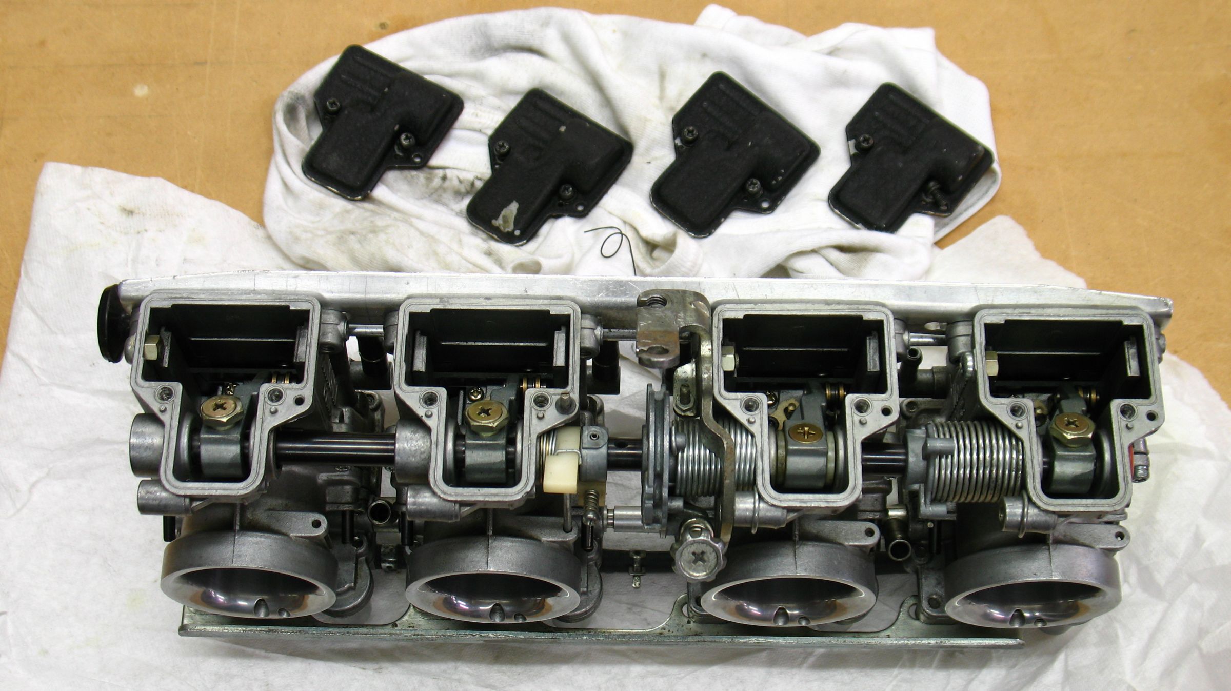

T36 D3 H (RS36) :S
Might be too large, but will see....................................................................,,,,,,,,,,,,,,,,,,,......................................................................
Is there any way to determine their age?
Heres a pic with all the tops off! :woohoo:

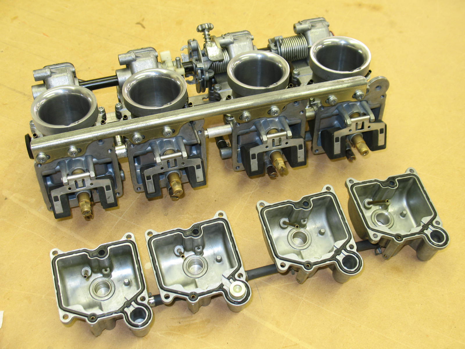

Here's a pic with the bottoms off :lol:
After removing the floats and retaining screws, the valves were flopp'n in the bores, and I could lift them out with no resistance at all. They're tight now with good/supple o-rings from an extra set of float valves from the BS34's. Perhaps that explains the fuel overflow which the ebay seller noted in his listing.
Seems to me if the o-rings are no good, then it doesn't matter if the float valves are good...gas will get past the outside of the valve assembly.
