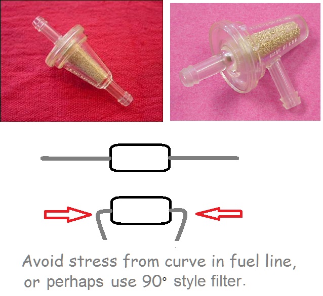

Is it a see-through filter with a paper element? Those are not for gravity feed systems. They simply stop flowing, even when perfectly clean. They might work for a few hours or days, but eventually stop, or just trickle.
This video shows the filter not flowing until I presuurize the tank. Then it flows. That filter is designed for cars with a fuel pump.

Yeah I have a paper fillter, so I'm guessing I will have to change that asap!!
- Posts: 23566
- Thanks: 2952
Re: My Kz550 carbs aren't sucking enough gas
28 Mar 2016 08:52
You can get one at your local bike/dirt bike shop. Even a lawn mower shop.
