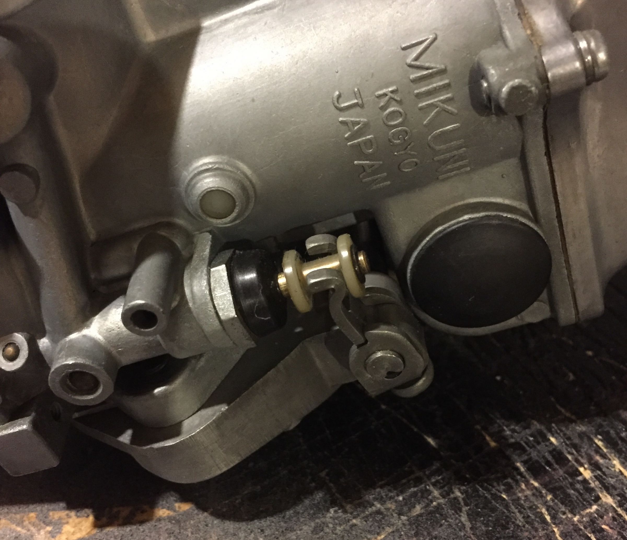

Re: Overly Rich Mixture - idle to 1/4 throttle
12 Apr 2016 20:44 - 12 Apr 2016 20:46Right.... All three of my 26mm carb sets have that plastic clip the pushes and pulls the enrichment valve up and down.

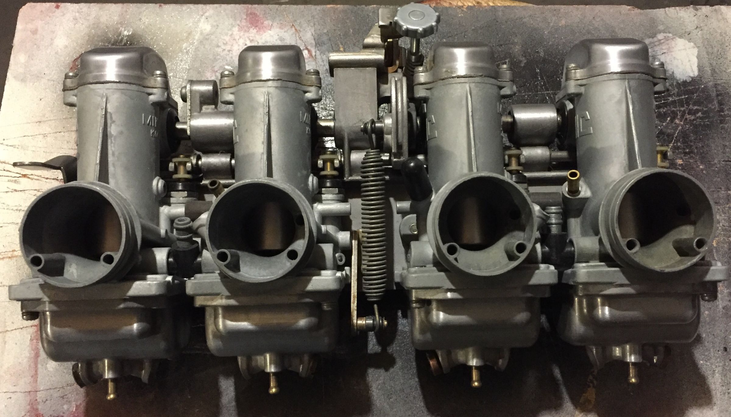

Well, did some more on the carb problem last weekend - thoroughly investigated my theory that maybe the choke plungers were not coming down fully with the choke "off." Took each carb in turn and blew through a tube into the choke air inlet port while lifting then releasing the plunger by hand. In each case there was a positive opening and closing action and each plunger was definitely fully home when released. Also, in the fully closed position of the choke, each plunger was in the same position as when manually pushed down, without the choke lever connected. So that kind of rules that possibility out.
I spoke to a local Kawasaki mechanic about the problem - he said "That'll be your slides in back to front which is causing the fuel to be sucked directly in through the main jets, bypassing the pilot system." It sounded feasible, but I was pretty sure I'd got the slides in the right way round with the groove in the slides correctly engaged in the slide chamber locating pins. I checked anyway and was "disappointed" to see that this quickfix was not the answer!
IThought that I'd revisit the float levels as I had just about exhausted my patience (and options for a solution.) Looks like I have set them way too high! I should have been using the bottom part of the carb body where it meets the float bowl as reference point, Due to inexperience (and little attention to detail) I had been using the edge of the carb about 4mm above it, which meant that it was always going to be too high!
As most will be aware, a very small adjustment of the tang on the float results in quite a large change in fuel level. In this case it turned out that a change of only 0.3mm on each tang brought the fuel level down to the specification (using the clear tube test.) I'm yet to refit the carbs but will post results when I get a chance to retest the setup. Hope that this is what has been the problem all the time .
