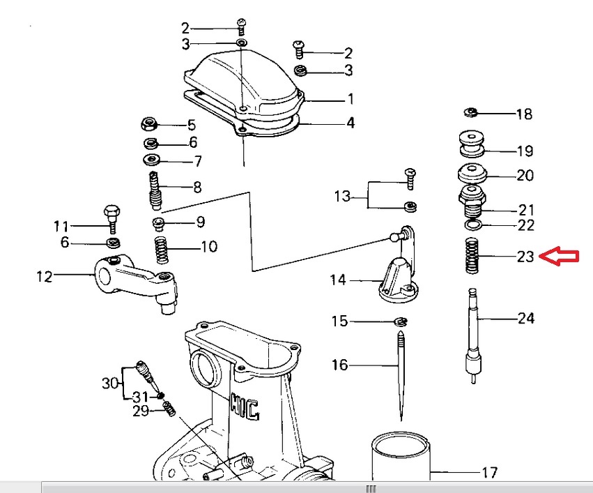

Tried to attach some pics of the relevant parts manual pages but .pdf scans are nogo - have to take a photo instead and attach as a .jpeg.
In the meantime and to hopefully explain - the return spring sits under the starter plunger cap and pushes against the lip on the plunger "piston" (for lack of a better word); this spring is compressed when the choke lever is lifted to the "on" position, when the choke lever is pushed down ie "off" the spring SHOULD return the plunger to the fully closed position and shut off the enriching fuel system (choke).

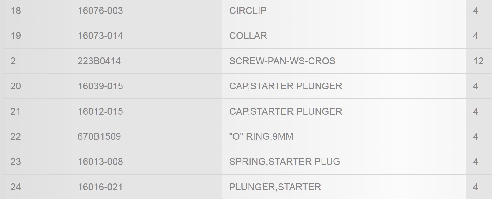

- Posts: 18568
- Thanks: 2103
Re: Overly Rich Mixture - idle to 1/4 throttle
12 Apr 2016 19:16 - 12 Apr 2016 20:36
Last edit: 12 Apr 2016 20:36 by Patton. Reason: add part numbers
The following user(s) said Thank You: weales
- missionkz
- Posts: 1622
- Thanks: 184
12 Apr 2016 19:36
I'm not sure those springs exist in the carbs on my bike now. WTF?
I'm going to slide the shaft out of my back up carbs, same year 26mm, and see if they are in those and maybe I lost the in ones on my bike from years ago rebuilds.

- Posts: 23539
- Thanks: 2945
12 Apr 2016 19:44
I don't remember having them.
- weales
- Posts: 247
- Thanks: 31
12 Apr 2016 20:23
No return springs, mmmm.....? unless someone has put some sort of pin through the plunger shaft under the collar (to give the choke lever something to push against to push the plungers down) they will stay up and the choke will be "on." - N'est pas?
