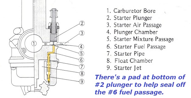

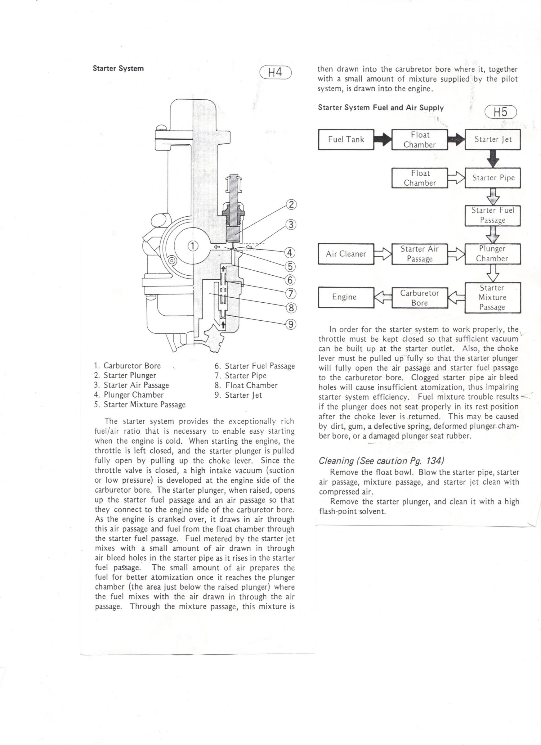

This may well NOT be the answer -- But it's remotely possible that the enrichener circuits might be malfunctioning when supposedly closed and continuously allowing an overly rich mixture into the combustion chambers.
Perhaps a linkage issue with the choke plungers?
Or the plunger caps are deteriorated or missing?
Or for whatever reason the plungers are not fully closing?

Removed plungers and inspected "pads" under plungers - all intact and in good condition, cleaned plungers and ports
Checked that plungers are fully seated when choke off
