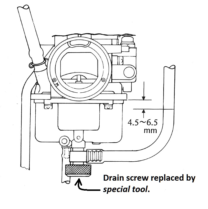

Modrummer wrote: Ok so I took the carbs off to do the clear tube float bowl test. I got the first carb perfectly set. Went to do the second carb and no fuel would come out of the drain plug??? Gas VERY slowly goes down the funnel and gas line I was using to feed the carb, but none came out of the drain. When I took of the float bowl again it was wet with gasoline in there (though definitely wasn't filling up all the way). The floats move freely and appear to be operating perfectly.
Thoughts?
The float valve might be stuck closed (pointed tip of the float needle stuck inside the seat orifice).
Clear tube test:
It's often possible to perform the clear tube test without the special tool by using a tube size that fits snugly into the drain hole.
Minimal leakage from where the tube is inserted doesn't invalidate the test.
Good Fortune! :)

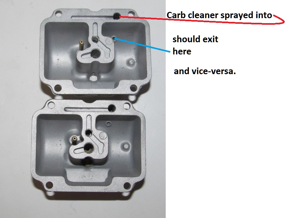

Ok I am more confused than ever. UPDATE: Both carbs have been adjusted per the clear tube test. I managed to get the stripped pilot jet out and replace it with a new one. I cleaned the pilot circuit as well as I could and it seems to be functioning (can spray carb cleaner in one hole and it comes out the others). I have the pilot air screw turned two turns out from all the way in. I have a good strong spark. And yet, it still won't start. I can get it to sometimes POP (backfire) out the exhaust, but that's it. If I use starter fluid it will act like it's going to start for about half a second, and then die.

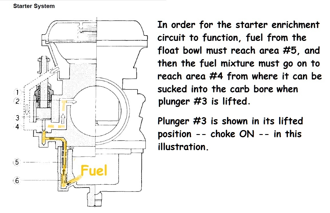

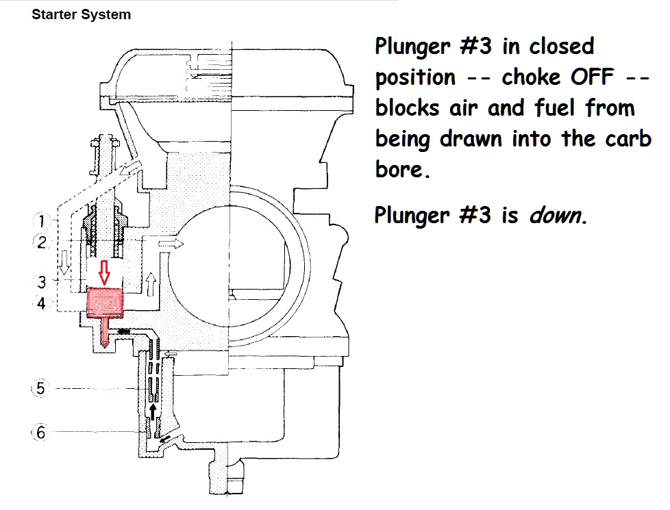

Starter system (enrichener circuit) might be clogged, resulting in non-functioning choke.

Patton wrote: Starter system (enrichener circuit) might be clogged, resulting in non-functioning choke.
Ok I cleaned the choke circuit as described and still no go.
