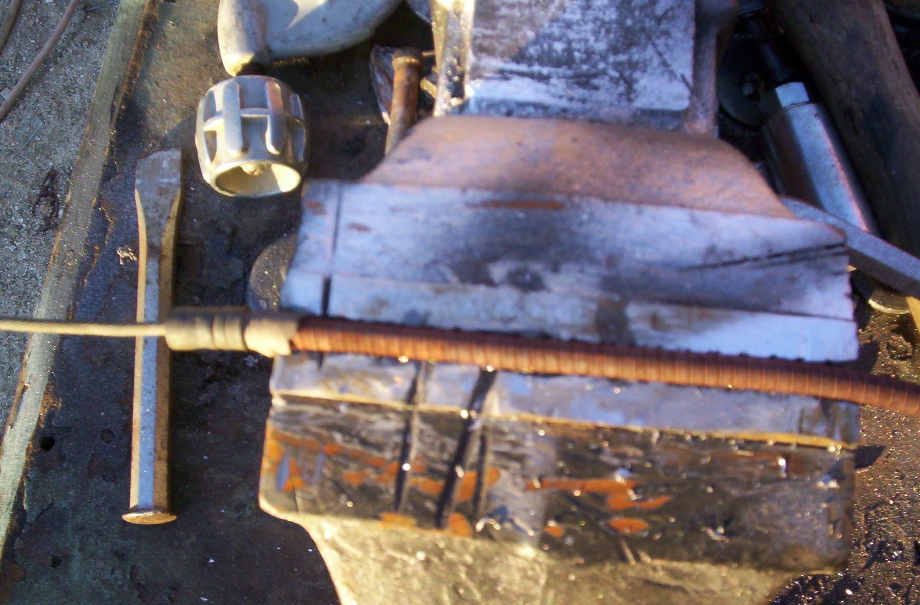

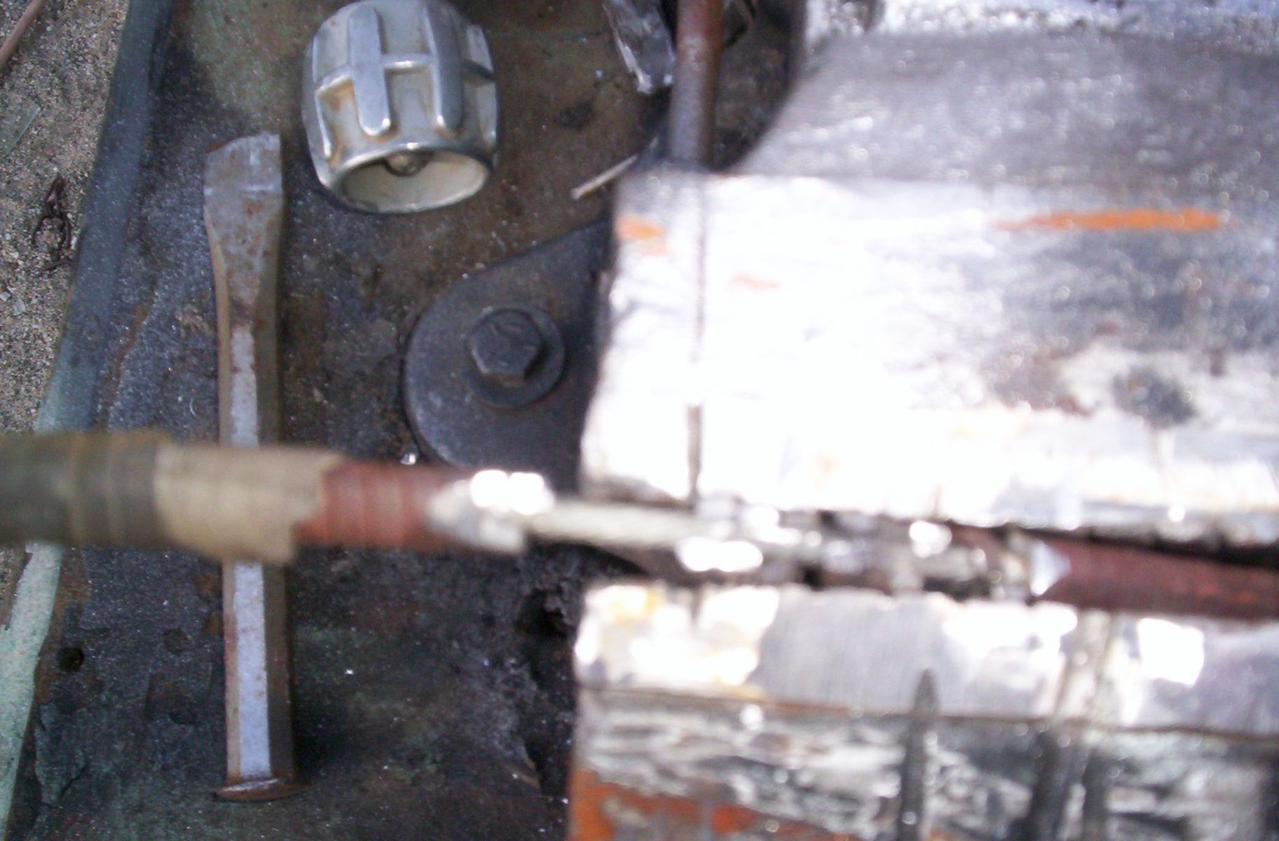

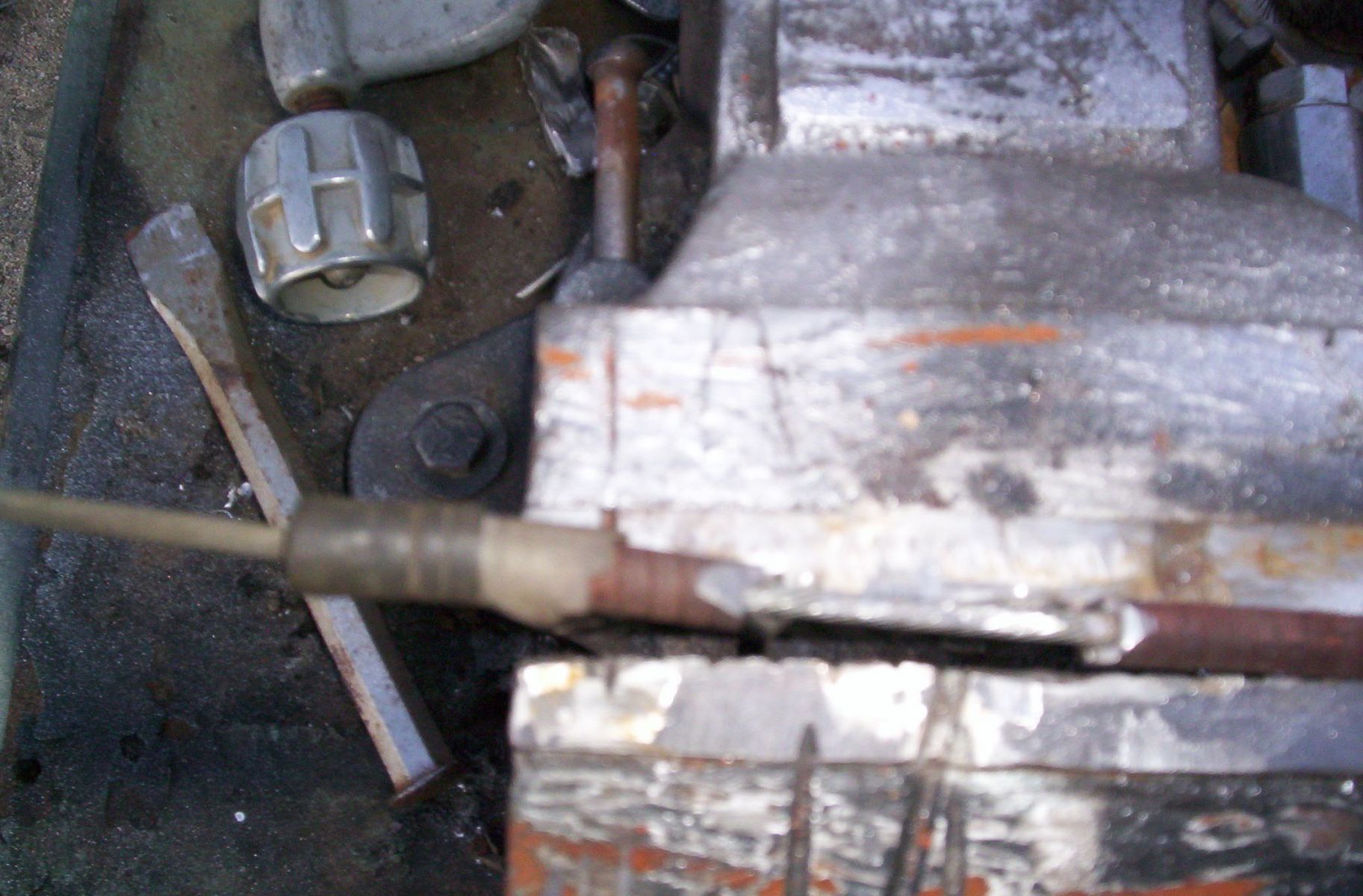

I had a old Honda 350 clutch cable laying around so I ground off 1" to show what I meant by grinding the cable.
