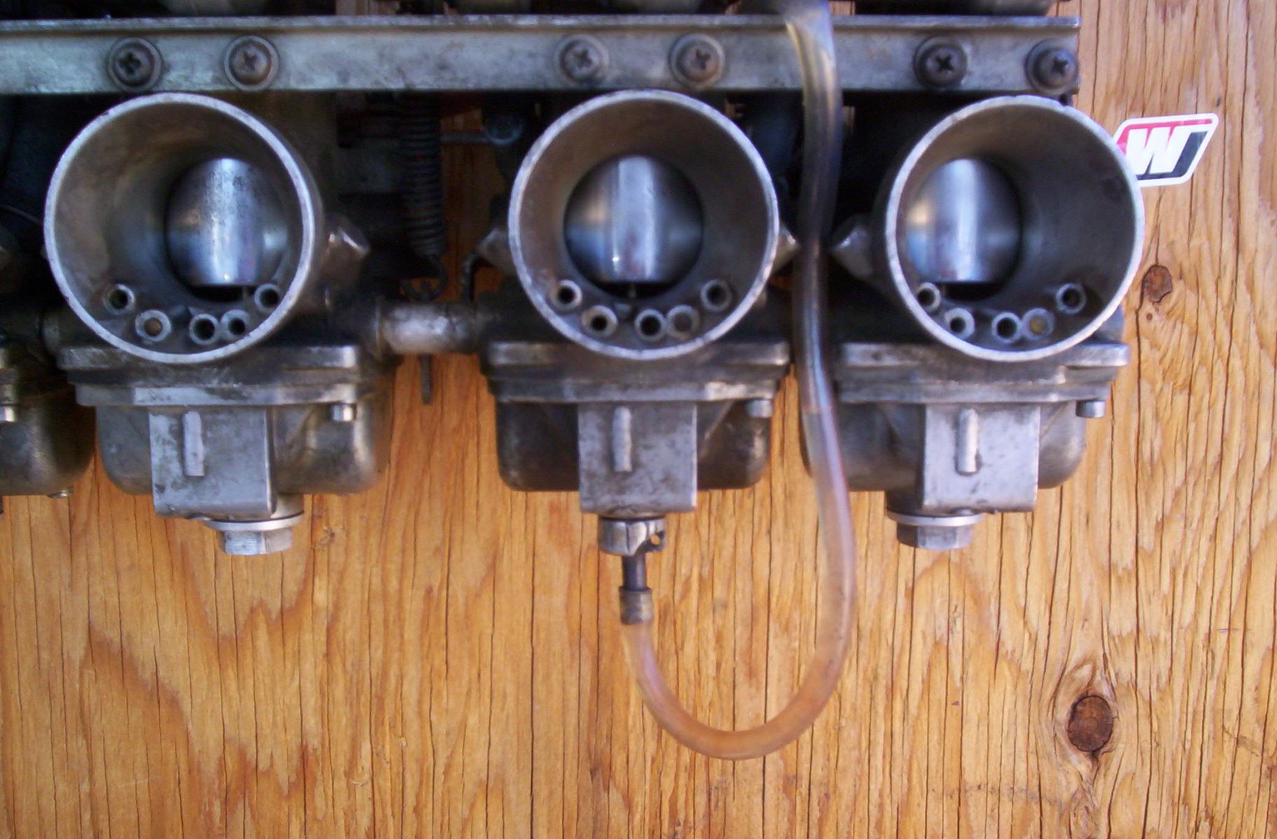

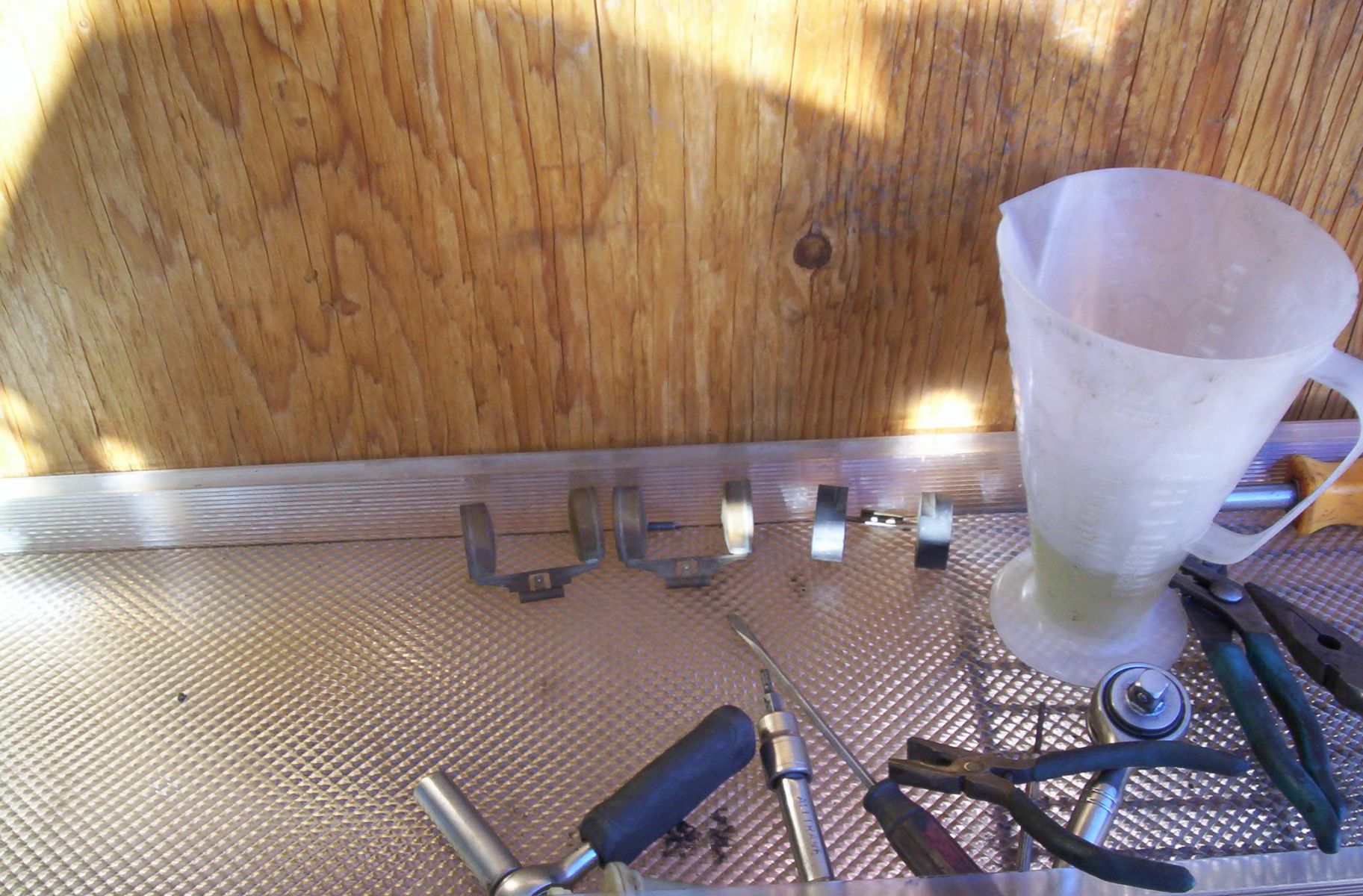

After fiddle FKing around trying to get the float levels right for three hours, I finally gave up. The pivots are too sloppy and worn out. #1 developed a leak a year ago so I put in one from my VM 28's. Pissed off, I had lunch and took a break. I have some from a KZ 900 VM 26 but they had been in a box for years and didn't look too good. I pulled the other three out of my 28's and put them in. I made sure they were streight and the tangs were level with the arms. All but one tested perfect. The tangs on the old ones were bent up but no adjusting of the arms or tangs would make them right. Too low or too high. Ether I'd have the level at the gasket or no gas at all. :angry: What made matters worse, the throttle cable I bought last year as a spare IS TOO LONG. :angry: :angry: Another eBay FK up. I have a policy of not leaving feed back until I'm sure it will work just for this reason. The bike's back together and running.
Time to have a beer, dinner and chill. I'll recheck the levels and fine tune it in the morning. :dry:

Finished putting it together and went into town. Running a little lean just off idle to mid range. Went through them again. Everything clear, float levels spot on, mixture screws set, still a little lean. Before I jump to a bigger jet, I'll raise the needles a notch. The plugs look good besides the purple tint to them. :unsure:

Bike's still running like SHT. I'm going to try to raise the float levels a bit. Seems to be starving for fuel after I use the power for a while. I don't think they are opening enough. More in the morning.

A while back On my stock 24s I checked the level and they were more in the middle of the lower bowl so I moved it to the lower edge like everyone shows and I was running into this so I moved em back and it went away and was back to running perfect..... sometimes like they say if it ain't broke don't fix it....... not gonna say if this is your problem but it seemed to be mine.

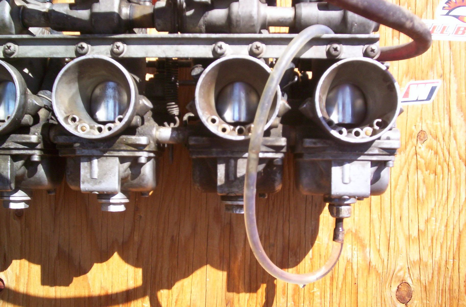

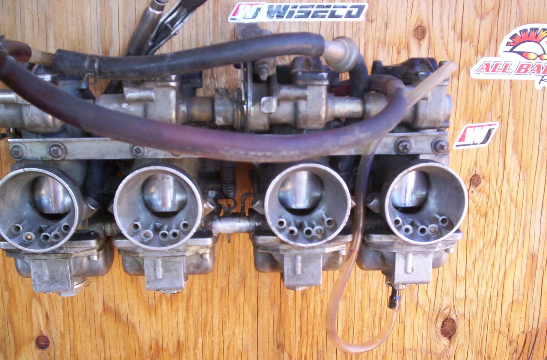

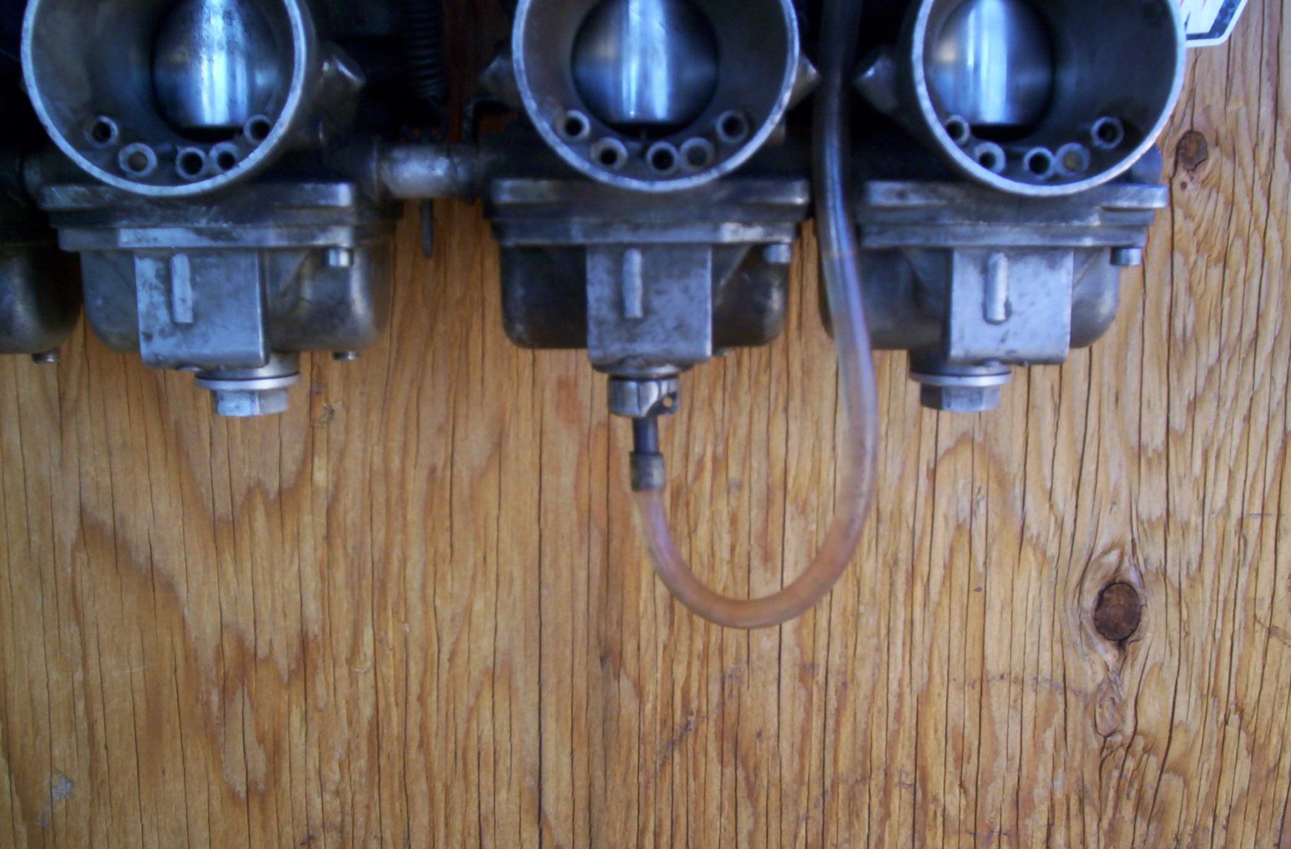

The problem was two fold. It would be rich on the bottom even though I had the smallest jets that would run it. When on the side stand it would seem rich but when I sat on it upright, it would smooth out. Sloppy floats and too high. These 33's are obsolete and there is little info on them. Since I got them, it's been trial and error. To make matters worse, I have 2.0 slides not 1.5 as Mikuni lists for the Kaw's.
