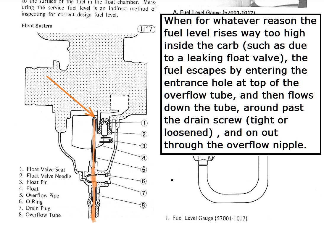

11 Nov 2015 06:20 - 11 Nov 2015 06:22eddiem wrote: . . . I need to look but wouldn't these carbs have an overflow hose?
The following diagram shows how the overflow circuit is supposed to work:
The overflow circuit may be non-functional for whatever reason, such as blockage of the overflow tube or overflow hose.
With the drain screw tightened, may spray carb cleaner through the small hole at top of overflow tube and watch for it to exit from the overflow nipple at bottom exterior of the float bowl.
Always wear protective goggles when spraying carb cleaner because the spray always backfires. ALWAYS!
In extreme cases of excessively rising gasoline levels, even a correctly functioning overflow circuit may be overwhelmed.

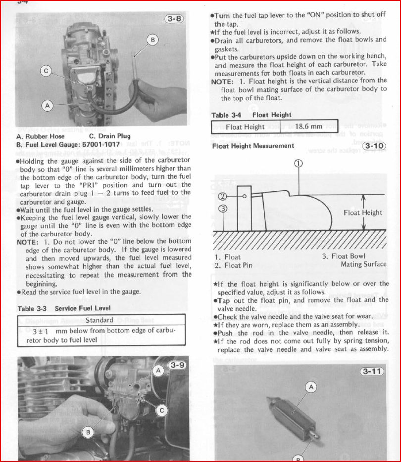

finely got the carbs back together. I set the floats to specs (18.6mm). when I do the clear tube test I'm using black hose with a glass tube. If I hold the tube up to the carb the gas doesn't come to the top till I lower it well below the edge of the carb only then when I raise it up to the edge does it show. Am I doing this right?

- Posts: 8227
- Thanks: 2700
Re: Kz1100 running very rich
14 Aug 2016 14:33
14 Aug 2016 14:43
exactly the setup I'm using. maybe I'm not giving enough time for the gas to come up?

14 Aug 2016 14:47 - 14 Aug 2016 14:47
Maybe. Are you setting the petcock to PRI before opening the bowl screw?

I have a fuel bottle on an IV stand feeding the carbs. I fill the carbs with gas then open the drain on the float bowl.

14 Aug 2016 14:53
So the bottle is free to flow fuel when you open the bowl screw?
