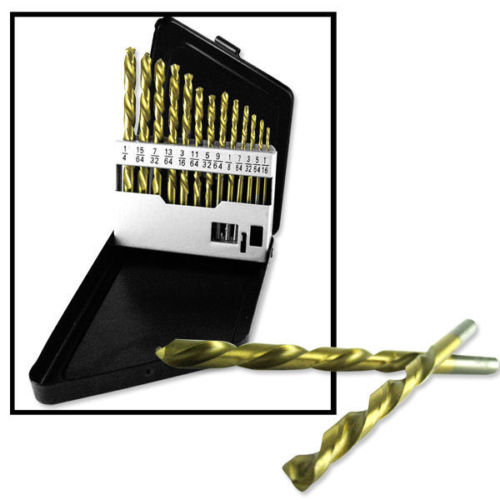

No eBay APP ID and/or Cert ID defined in Kunena configurationI won't disturb them if I don't have to. I ordered reverse drills just for this kind of problem. Should be getting them today.

Just my 2 cents worth. Those left hand drill bits are great for steel screws/bolts but I'm afraid all they will do is drill a hole in that brass jet. If it were my bike I'd try to clean it first with a guitar string, as others have suggested, or grab the top part with some vice grips and try to remove it. I find that once clamped onto the fastener a tap with my hand works better than trying to muscle the screw out.
Now drilling or using the vice grips would be a last resort and ONLY after I have sourced the replacement jet.

That's why I suggested the guitar string. Some pilot jets have emulators that can get clogged. It has to be removed. All the suggestions above are right. The drills ARE a last resort.
