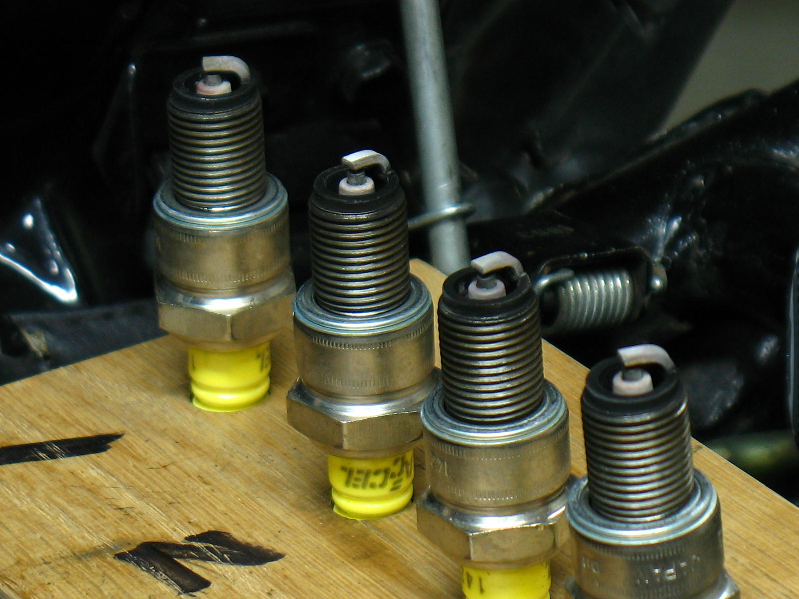

Daveo, those plugs look a bit white to me, is that running a bit lean?

I'd go one step up on the pilots. Blue is lean.

03 Aug 2015 23:55 - 04 Aug 2015 00:02swest wrote: I'd go one step up on the pilots. Blue is lean.
Note the header tube color near the head...same at the collector. :evil: They were golden when I bolted them to the bathtub head (GPZ cams), about 2k miles ago. This head setup squeezes way more juice than the original J-head it replaced, and really makes the header sing. :kiss:
After a cool, late night cruise, I took these pics when I got back...
The carbs have 130 main, and 40 pilot jets. The bone-stock spec is 120 main, and 37.5 pilots.

04 Aug 2015 00:24Tyrell Corp wrote: Daveo, those plugs look a bit white to me, is that running a bit lean?
On a CV carb opening the throttle bypasses the enrichment circuit - the 'choke' . Saying that my 750 seems to start better on a bit of throttle, although the carbs have been messed with quite a lot with an air corrector kit and upjetted plus needle change for pod filters.
That bike looks really clean, nice.
See the last plug pic taken this evening...color looks better to me, and I'm not getting much popping on deceleration, as when the other pic was taken in the Spring.

04 Aug 2015 00:35 - 04 Aug 2015 00:52swest wrote: I'd go one step up on the pilots. Blue is lean.
I had 42.5 pilots in there back in the Spring. It was suggested to step back down one size, due to excessive carbon buildup at the end of the threads. After experimenting with different main jets, I settled up to 130 which eliminated high-end pops, and accelerates me to infinity without hesitation. :woohoo:
