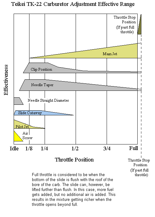

Ok, I'm slowly answering my own questions here. Some clarifications... What I've been calling the Secondary Main Jet (as per the manual & parts list) is the jet thats screws into the needle jet the the needle slides up & down within.
Below is my Z750 carb
So here I go answering my own questions again. Feel free to correct me if I go wrong.
According to this diagram, anyone who's interested in their carbs has seen this, right? What this tells me is if I change my Primary Main from #62 to #68 as proposed that is going to effect me from about 1/2 to WOT, if I change the Secondary Main (Needle Jet) 2 sizes that will effect me from before 1/4 right through to past 3/4 throttle. I don't spend much, if any, time at WOT so it make sense to change the Secondary mains or Needle Jets.
Best to go back to PJ Motorsports to see if I can change my order. Lucky for me they are in Portland and that's where my parcel is being consolidated, so that's a win...
Attachment Carbinnards.jpg not found
Attachment JetRange.gif not found

In my experience, with a wideband O2 analyzer, the needle and needle jet have most of their affect in the lower throttle position ranges. The most affect is where the needle's first taper starts to get near the mouth of the needle jet. That is where the needle has the greatest affect, and the main jet just barely starts to have any affect. As the throttle opens more, the needle's affect gradually drops off as the main jet affect gradually starts to take over.
Here is the perceived affect I get on the 550, which is a simple (manual slide), but the needle versus main holds more or less for most carbs.
CV carbs will have several other factors, like spring tension on the diaphragm, air jets, etc. On Keihin piston CV's, the air jets were one of the things I adjusted, but they may be fixed on the diaphragm type CV's.
The throttle cutaway can be ignored unless you can actually get different cutaways. But usually you can play with the needle instead. The main purpose of the cutaway is ensure there is no vacuum at the needle jet when the slide is closed all the way. By exposing the needle jet to the intake air, the needle jet has atmospheric pressure (instead of vacuum) to prevent fuel from siphoning up the main passage. That way you can fine tune the idle using the idle mixture screws.
Ignore the needle straight diameter unless you are comparing two different needles with different diameter shafts.
Ignore the needle taper unless you are comparing two different taper needles.
Ignore the throttle stop as that is only for manual slides.
On the 550, the air screw and pilot have no affect in the upper throttle positions, but that may be different on your carbs as you indicated.

Is the chart with the blue circles supposed to be for a 750? It is way off compared to what my service manual says. It is more or less the same as what Loudhvx posted. Are you sure it is correct? A pilot that goes all the way to WOT sounds strange.
