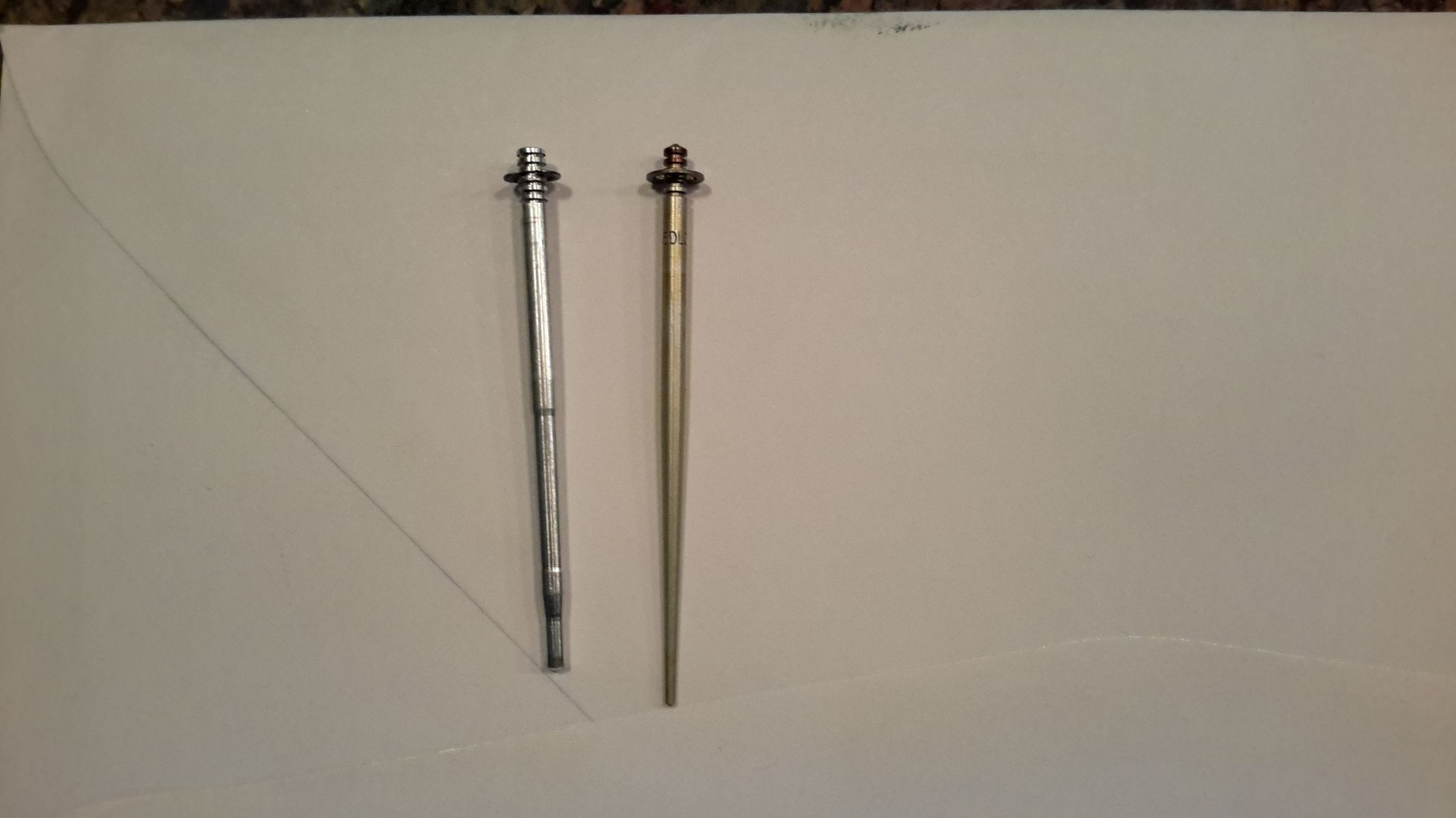

Thanks Steve, just purchased some, now I need to figure out the jet needles. I will post a picture of the needles I have, maybe someone will recognize them.

Ok, here is the needle I am talking about, the one on the left I found in my bs34cv carbs, the one on the right is from a 78 z1 00 vm26ss carbs, the needle has no number and I have never seen a taper like that before, no telling where they came from but I feel they are wrong for this carb set, can anyone I'd this needle?

The needle on the left somewhat resembles the ones on my 34cv carbs.
Stubby and blunt
But there is only one grove for the clip and yours looks like it is stepped?
Stubby and blunt
