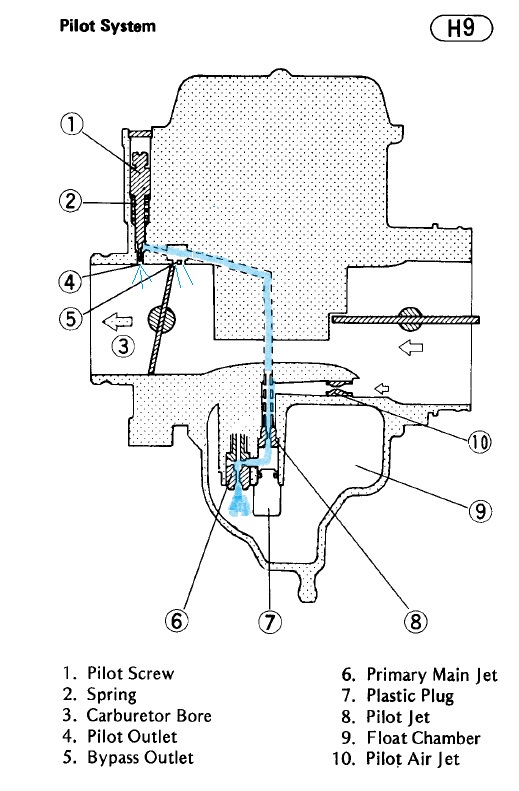

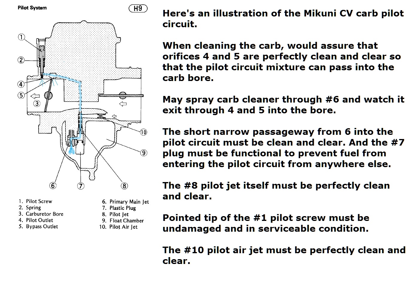

The carb pilot circuit should be as-new clean and clear.
No gasoline should be allowed into the freshly cleaned carbs without first passing through a good aftermarket in-line fuel filter.
Here's an illustration that might be helpful toward assuring that the orifices are clear where the pilot circuit exits into the carb bore.
