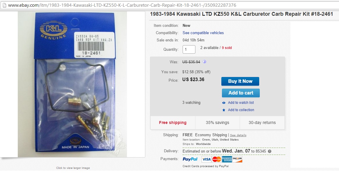

No eBay APP ID and/or Cert ID defined in Kunena configuration$80.. :pinch: Hopefully that's for all 4 carbs.
In case someone else needs.... Here's another @ $23 for one carb....
