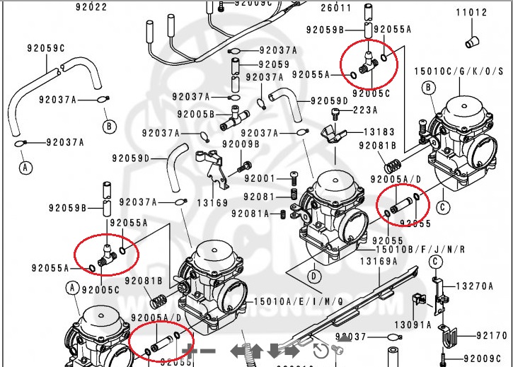

27 Oct 2014 05:55
Diagram, for reference:
www.cmsnl.com/kawasaki-1994-c4-zr750_mod...t/E1611.html#results
If not already done, would check integrity of the o'rings on the various fuel pipes connecting the carb bodies.
And also check for the more remote possibility of a cracked fuel pipe.
Presumably, all the hose connections have already been inspected and found to be leak-free, and with no cracked or deteriorated hoses.
