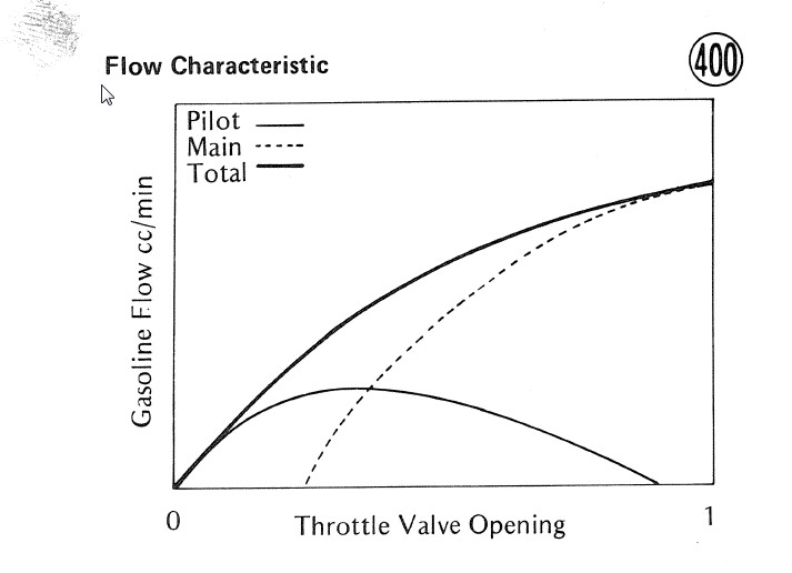

I believe it should not because the slides should be all the way down. See the graph taken from the service manual. The main jet doesn't kick in until about 1/4 throttle opening ballpark.Schmeck wrote: I have b7es in already . My local zone store doesn't carry b6es unfortunately unless I go with the resistance plug with the r in the number . Does clip position affect idle ?
