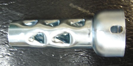

This is my exhaust btw . I ditched the shorties and ran them alittle longer.
