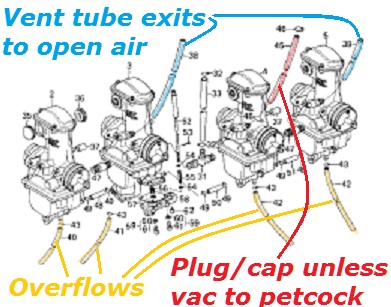

I did notice when I had the carbs off that they had a screw in the end of one of the vent tubes. I assume that carb was overflowing at one time or another. The parts inside the carbs all looked in good condition, so I think I am just going to remove that screw. Would that screw in the vent tube cause the bike to run funny? Has anyone done this? Noticed any changes? Thanks :woohoo:

None of the vent tubes or overflow tubes should be blocked. The only possible reason I can think of for blocking any tube on the carbs would be if the owner swapped a vacuum operated petcock for a manual petcock. In that case he would need to block the vacuum tube on the carb that would have been connected to the vacuum operated petcock.
Can you provide a picture of the carb with the screw in it? Ed
