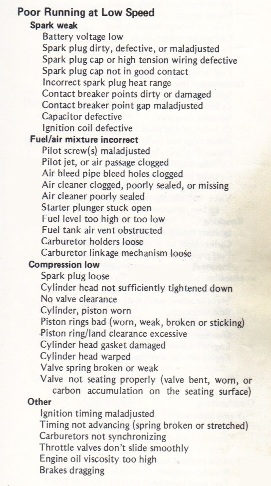

Re: hesitation off idle
16 Oct 2013 12:09 - 16 Oct 2013 12:41megadub72 wrote: ... It idles very nicely, so I am guessing the pilot screw is pretty good....
More than just idle quality, the pilot screw regulates carb performance throughout the pilot circuit, including tuning for a strong smooth pull-away from idle.
Same for sync.
Would suspect that pilot circuit is either too rich or too lean, either of which could contribute to poor performance at pull-away from idle.
Of course, there are many possible conditions that might result in the reported issue, such as noted in the FSM:
Last edit: 16 Oct 2013 12:41 by Patton.
