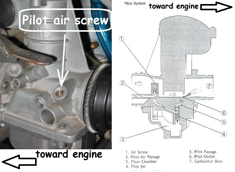

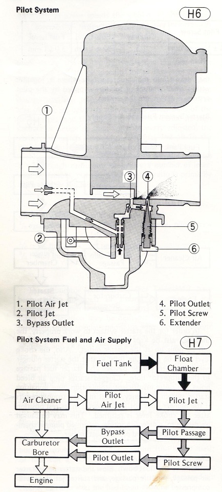

17 Oct 2013 08:01 - 17 Oct 2013 08:12Re-sizing the main jets might or might not improve carb performance in the WOT (wide open throttle) range, but won't influence the "hesitation off idle."megadub72 wrote: ... am planning on pulling off the carbs next to change out the main jets....
But with carbs removed, the pilot circuits may be cleaned, which will likely reduce and perhaps eliminate the hesitation off idle.
Here's one cleaning method to consider:
Note that the pilot adjustment screws in the above diagram are side-located, as in this example:
If carbs have bottom-located pilot screws (instead of side-located pilot screws), the above procedure may be adapted to accomplish the same objective of assuring clear mixture passage into the carb bore.
A proper bench sync should also be performed, being sure to have the throttle screw set in about its middle position before adjusting the slide heights. Which is to enable further lowering when performing the final sync with engine running.
