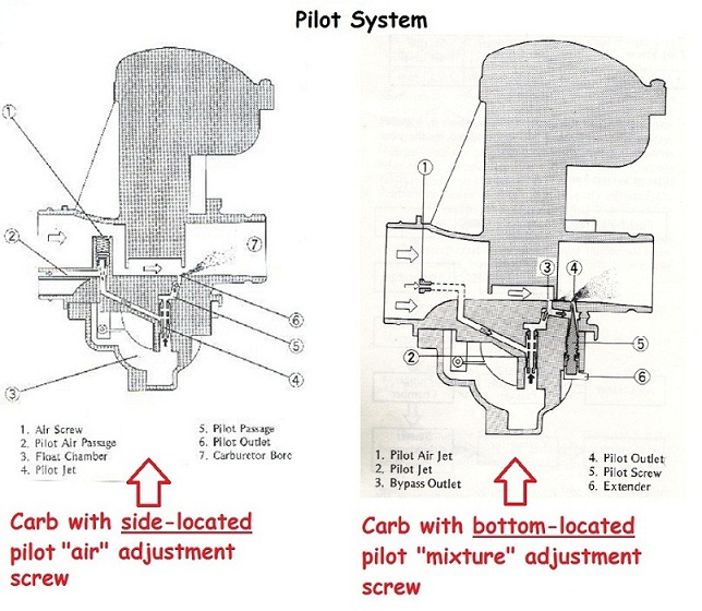

07 Oct 2011 00:17 - 14 Oct 2011 17:45abrambila wrote: alright, sounds like the carbs are coming back off again. it seems odd to me that it could be dirty when the new jets all came in completely clean. we'll see I guess.
any tips on cleaning besides blowing compressed air through everything? Last time I soaked in a carb cleaner bucket and then scrubbed with an old toothbrush, but apparently that didnt work. should I try a spray can of carb cleaner?
i know fuel is getting to the carbs because the bowls are filling up, it just must not be getting taken up into the airstream. odd...
thanks everyone
stock airbox on the bike by the way.
Wear eye protection because pressurized spray can carb cleaner always backfires toward your eyes. Always.
This pilot circuit cleaning method applies to carb with side-located pilot air screw.
The same basics may be applied to cleaning pilot circuit with bottom located pilot mixture screws.
Racing idle may result from outside air being drawn through old leaking carb holders. Or from other leak sources such as vacuum caps, cracked or loose vacuum line to petcock, etc.
There are also a few mechanical reasons (often throttle-cable related) which may cause a racing idle.
