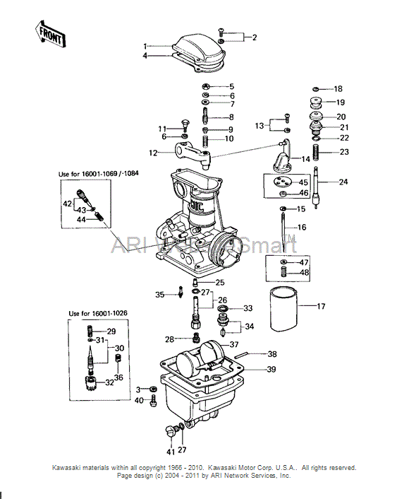

If you have a look at this diagram for your carb, look close at how the Needle goes into the slide valve. Look at how the spring holds the needle farther up, and that the adjustment clip doesn't sit down against the bottom of the slide. Check this, as I found a set of carbs miss assembled like this once.
