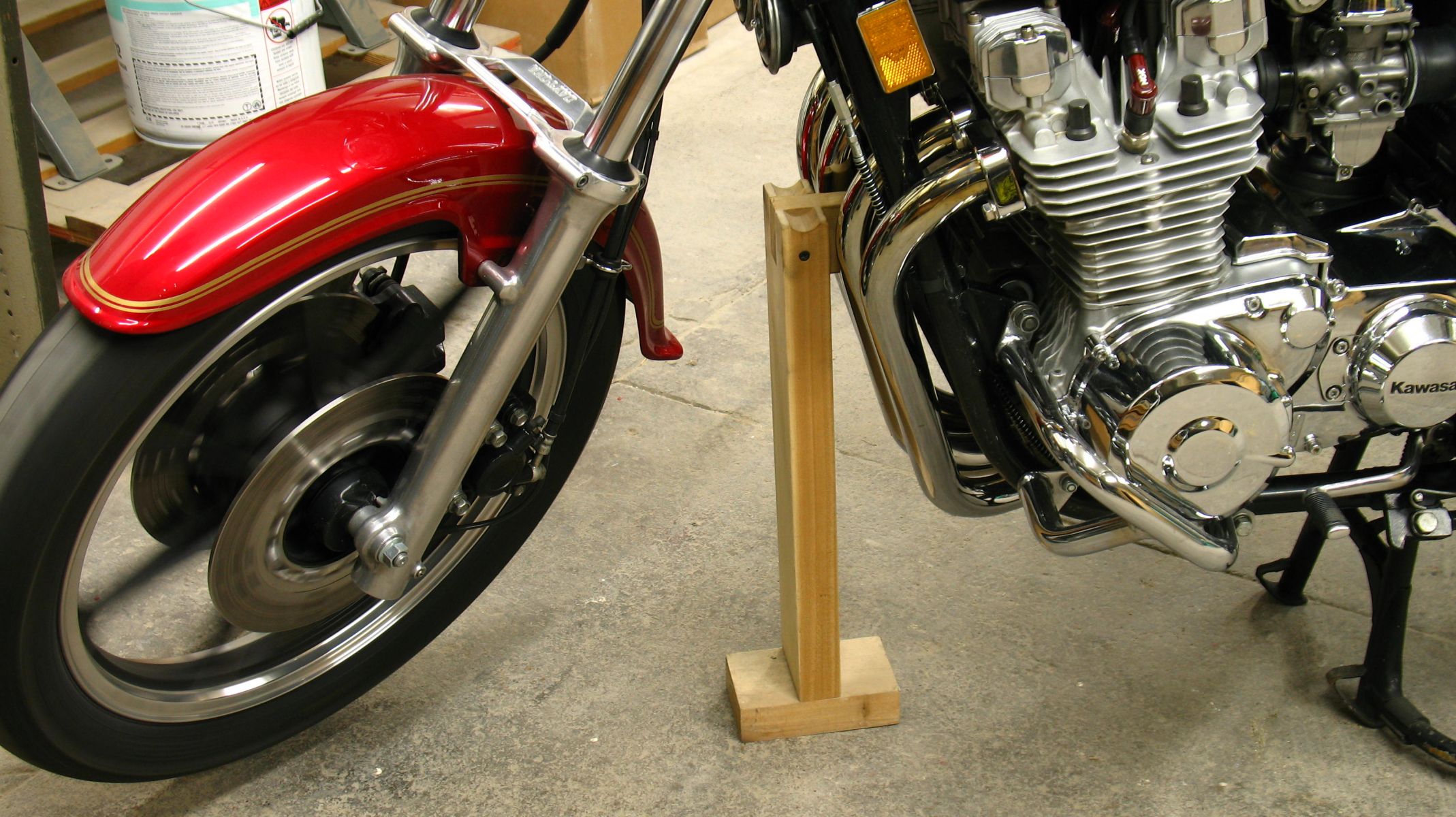

My inexpensive (cheap) approach to a triple tree stand for my kz750
www.kzrider.com/forum/21-tools/595750-ra...wheel-off-the-ground

as long as there is a large enough hole in the bottom of the steering stem for the pin to slip into it will work.

I've had great luck with this jig, and had the entire front-end off the bike to change the head bearings. I trust it as long as the bike's center-stand is locked, and the bike is positioned on a level and solid floor surface, and the bike isn't moved around too much while wrenching on it. Best to break-loose the nuts and bolts before jacking it, then final tighten them after the tire is back on the floor.
