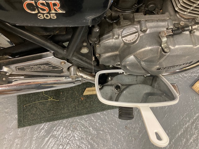

For those of us too old or too lazy, a mirror helps.
