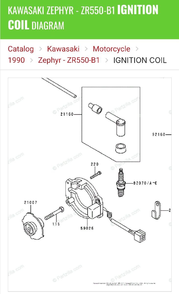

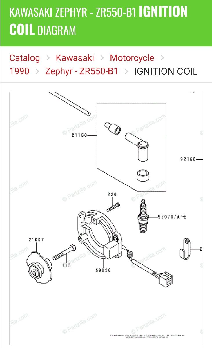

That's exciting! It gets me wondering, now that you mentioned ignition, how are you going to deal with the ignition pickup coils? I had an issue with that once with a kz550 and zx550 engine (mechanical advancer vs electric) for incompatibility of things such as the igniter, since it doesnt look like they will be plug and play. Your Zephyr only has one pickup coil and the gpz600 has two!! Just my thoughts for you to consider.

Incorrect, my Zephyr has two.

Whoops, mildly embarrassing. I was looking at diagrams, thus my mistake. The diagram didn't show the other coil. I'll try to be more careful!

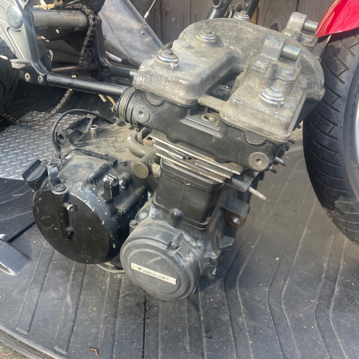

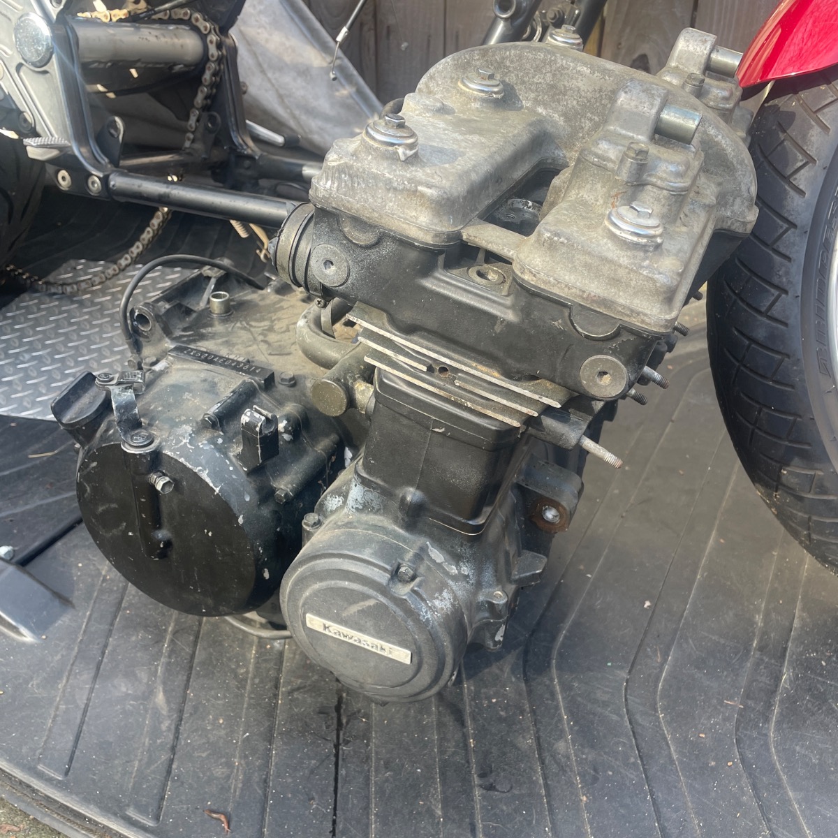

Went up to check out the bike and parts for sale this afternoon. The bad news is that everything was in pretty rough shape, and I didn’t get as much as I was hoping I’d be able to. The good news is I did leave with a motor and a few other parts for a lot less money than I thought I might spend.
It does feel a little bit like getting this motor to work is going to take just as much or maybe more effort than repairing my original motor. But what I can do now is work on both of them in tandem, and at some point make a decision about which one is actually going to get put in. First things first, the ZX600 motor needs a bath real bad. It’s too dark here now to take a picture, but I’ll try to remember to get one in the morning.

08 Apr 2026 11:43 - 08 Apr 2026 11:44did you get the ignition module and the wiring harness (easiest way to get the plug for the igniter, pick up coils etc - for my project I got a ZX6R loom for the dash, speed sensor etc and a GPX600 loom for the ignition module etc. I paid around $40 for each)Here’s a photo. It gross.
I got a radiator, oil cooler, and a handful of additional hoses as well.
