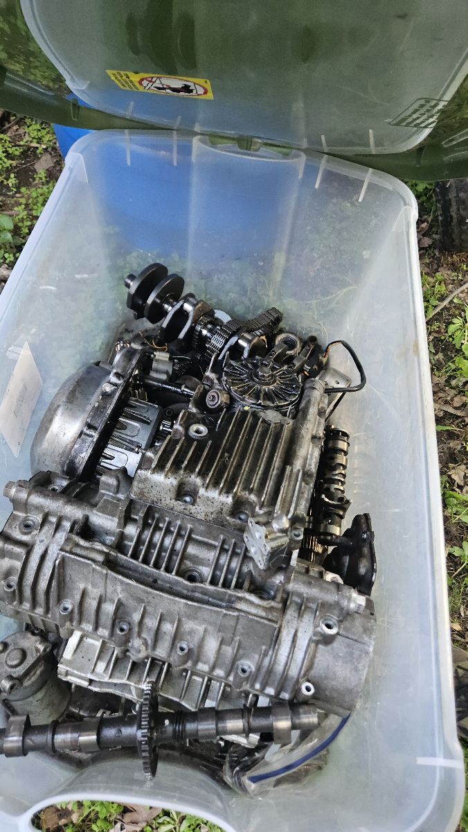

But in the process of restoring my bike, I struggled for years to find parts to replace the damaged ones I have. So I found a zr550 that only had 3,000 miles on it, but it had sat since 1995 and irreparable title issues. So I bought it for all the spares. And I found it’s easier to store a motorcycle in pieces and can be carried up stairs and stored out of the way. So I have low mileage engine but that sat for 32 years and will probably need all new gaskets before it could be started.

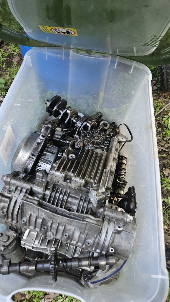

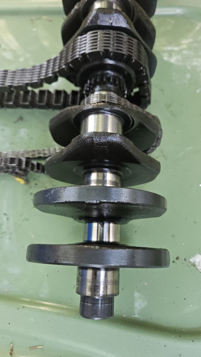

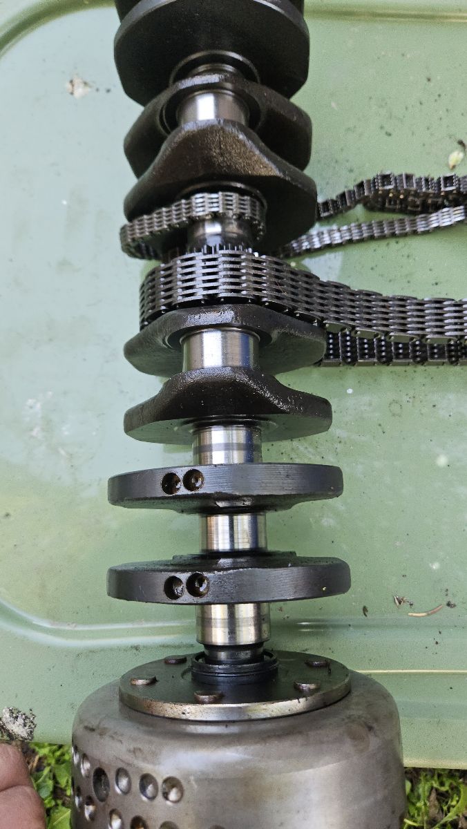

StereoOrdinary I want to help you and get parts out of my way. I have an old 1985 gpz550 crankshaft, primary chain, crank bearings, and many other engine parts.
If you are interested in rebuilding the engine, I can ship them to you if its within your budget to pay for the shipping. I can also take any measurements if you're interested.
I want to relieve you of at least some stress!

That would be amazing, thank you for the offer! I would be interested in the crankshaft, primary chain, cams, and any con rods and bearings you might have. I would probably want to pass on other large items like cases and covers. I’ll shoot you a private message and we can discuss the viability of shipping these parts. Thanks again!

Huge shoutout to Craig aka Bound for hooking me up with a crankshaft, primary chain, and four good con rods for my project here! I love this community!
I have had to put the project on hold for a little while. The engine stand I was borrowing had to go back home for some amount of time. Admittedly I don’t know what I need to be doing next anyway, so I’ll be doing research and talking to folks and trying to figure out what I need to do to fit the new crankshaft and so forth. The cost of all the gaskets and o-rings and such that I need isn’t overwhelming. But I did purchase another project bike, so I’m balancing a number of spinning plates right now. Will keep you all posted!
