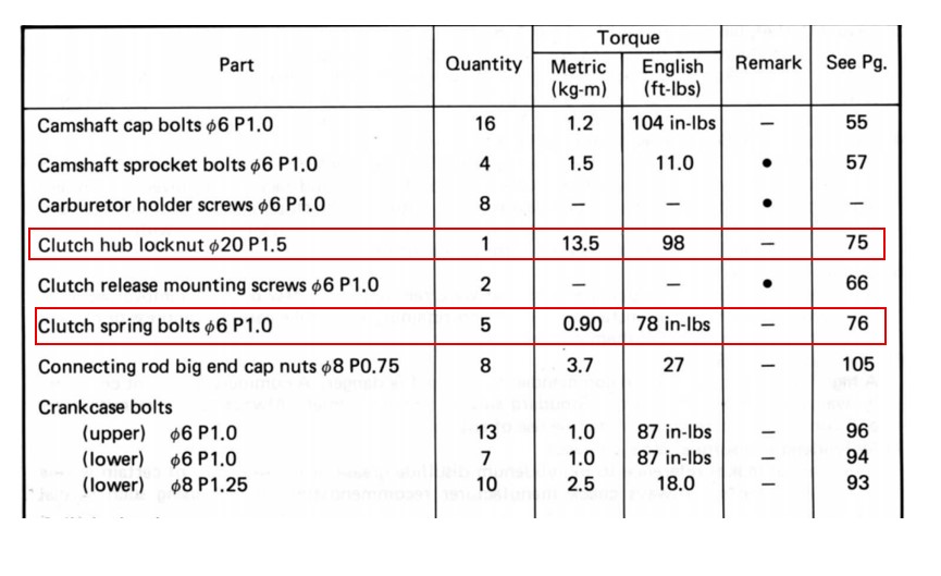

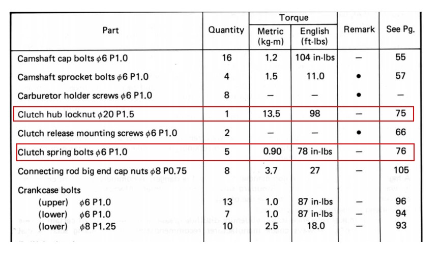

How much should I torque the bolts that hold the pressure plate on the clutch? The bolts with the spring behind them?
Project:
Project:
- Posts: 6878
- Thanks: 4330
Re: z750L: Repair starter clutch
10 Jul 2025 06:07
- gordone
- Posts: 1538
- Thanks: 93
10 Jul 2025 06:20Thank you
Clutch Hub lockout - 132.39 Nm
Clutch spring bolt - 8.83 Nm
I found the Clutch Hub lockout in my service manual where it gave me a range off 108-160 Nm (80-118 ft.lbs), but I will torque it to around 133 Nm than.
